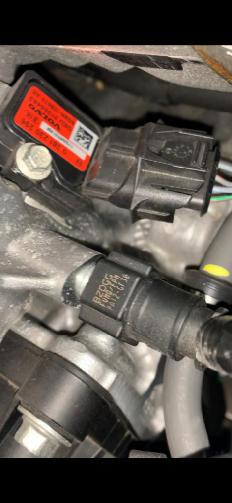

Racechip requires you to intercept two signals going to the ECU. They're related to the boost levels and air measurements. The Racechip harness comes with (A) and (B) wires.
(B) is the smaller plug and it goes in the front of the engine. This is simple to find and install the intercept.
(A) is the larger plug and it goes to the back of the engine. While the F-Type or X series of Jaguar's might have easier access to this plug it is VERY difficult to get to on the D5. I imagine it is equally difficult for users installing on an RR or RRS.
I tried to reach around beneath the windshield wiper cowl and manually press the release lever and pull it out. This proved totally futile and I ripped up my arms and hands trying to get in there.
To release the lever holding the plug in, you really need to jam a screwdriver or needlepoint tool and left the locking mechanism and pull the plug. The way I did this was to unscrew the sensor bolt (7mm on mine, but reported as 8mm on Jaguar's by another user), pull the MAP sensor, unplug it, rewire the intercepts into the sensor and connector and reinstall the MAP sensor.
