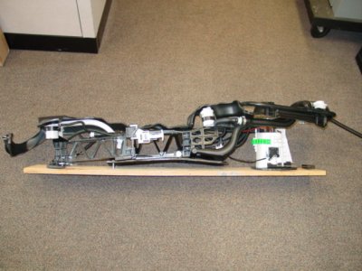

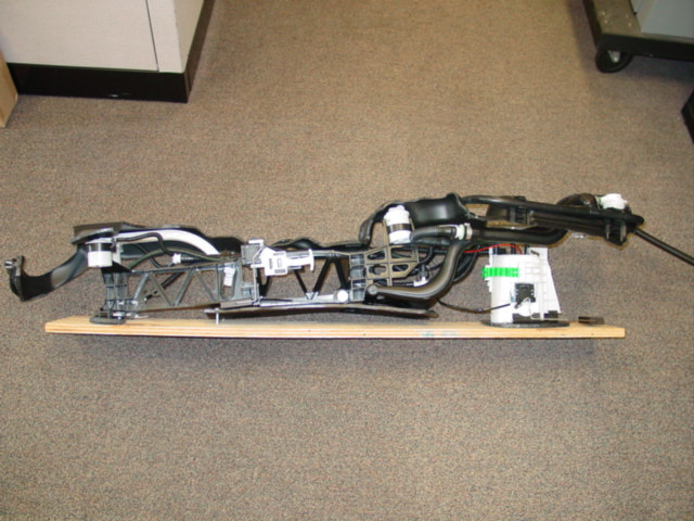

I have dropped the tank with the intention of changing out the sending units. Unfortunately the front unit is blocked by a baffle. I have no idea how to reach...thoughts?
RoverGuy7
Apr 24, 2013
178
It should not be blocked, but it can be almost impossible to reach, I personally cannot repalce the front one, my arm does not fit.

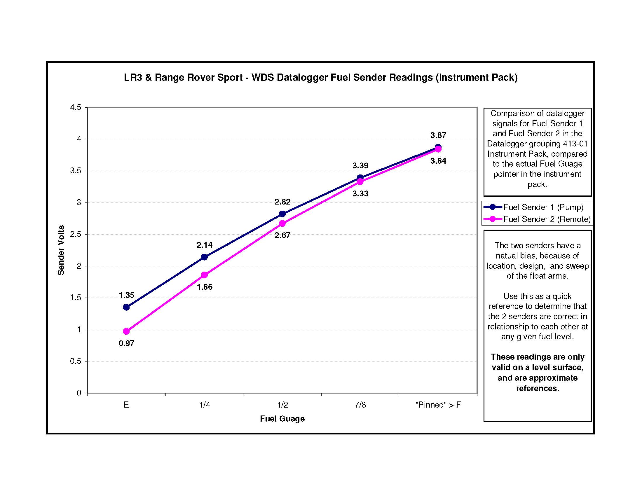

Curious thought could one splice so the Cluster recieved the signal from the front sending unit sent from the rear. So that instead of replacing the entire fuel tank if you cant reach the front unit the rear could be the only source of signal.
Sure your accuracy and gauge will move more with angle changes but its better than having no fuel level indicated at all.

You could splice them together, however it will not be accurate, more so when the tank is low. The senders do not read the same voltage at the same level, so even on empty, it would still show you had some fuel in the tank.

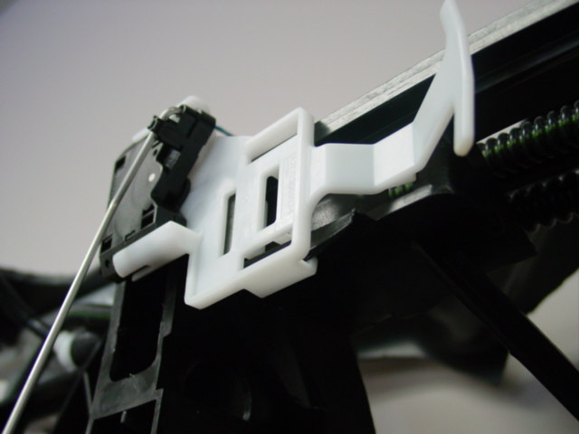

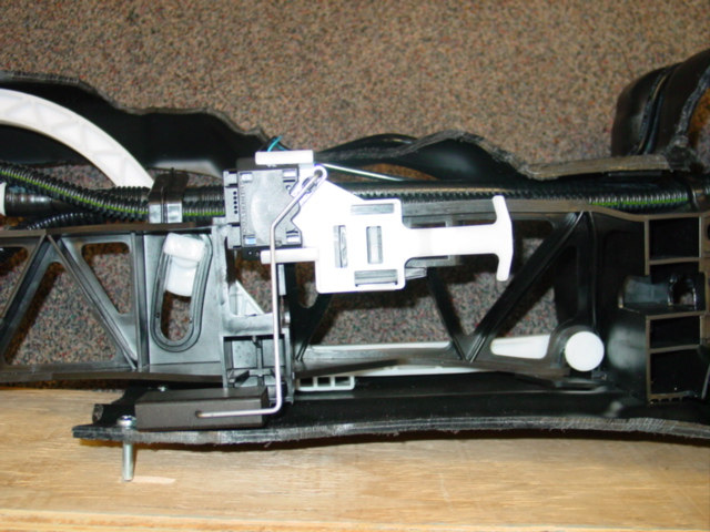

You have to pull the feul pump out. Then reach to the way outer left side of the internal infrastructure dropping your elbow all the way into the tank. I have pulled mine several times. Grab the white T bracket and lift out and it will slide out off the track.

Call it all you want, I have done it several times. I am 6'2 Slender built. My forearm is 19.5 inches long from elbow to finger tip.
You have to make sure all is clear on the left side (lines etc) and work your hand down the side and pop your elbow down into the hole, having better then average flexibility helps. It can smart a little when you pop your elbow in, but just a minor scraping on the back of my arm.You don't have to reach the sender just the T-Arm extension that you lift to slide it back off the track.
Even showed my indie shop how to do it on one they had in for service.

I used my left arm, going forward from back to front with the tank on the ground. looking down from the top into the fuel pump access hole you just feel down to the left sliding down the left hand side wall of the tank.
The insertion is not to hard either, you toss the sender down in to the tank on the left side and then put your arm in an pick it up, you can feel the track it goes on to.
