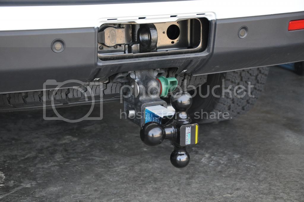

How much of a tongue lift (hight of the tongue part) did you require to get the load level? I have noticed that the OEM hitch drops my tongue about 3-4". It appears I would need a tongue that brings my ball hight about 8" up to get things level again to compensate for that silly adapter. I don't see that you are using a WDH so as you stated I think your assessment is correct.

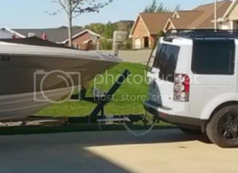

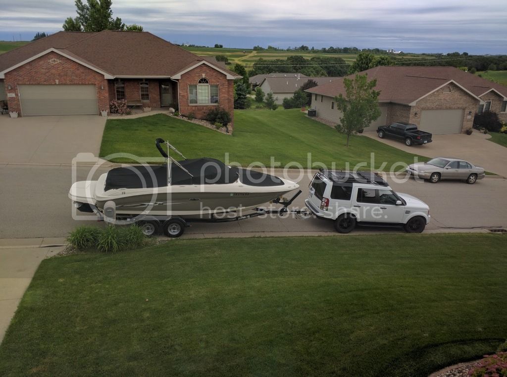

For my 2013 trailer a straight bar works great. I don't use a brake controller, my ShoreLand'r has dual axle 10" disc brakes with surge actuator which seems to work really well. I haven't felt the need to add a controller.
Zoomed in, sorry for quality.

I guess my question is why do people not find the oem setup with standard trailer setups to be enough? I see a lot of threads on other hitches and controllers, which I suppose you need if your trailer doesn't have a mechanical actuator type setup... but ya.. what is wrong with OE hitch?
I'm only one data point, but my boat is heavy as **** and I have towed it all over the place and never noticed any issues. Under braking its smooth and controlled (though you really know its back there, even with trailer brakes). I am pretty sure my trailer knows to not put the brakes on when in reverse based on the lights/harness which is ok to back into the water with because it has sealed water tight LEDs that don't burn out on contact with water.
