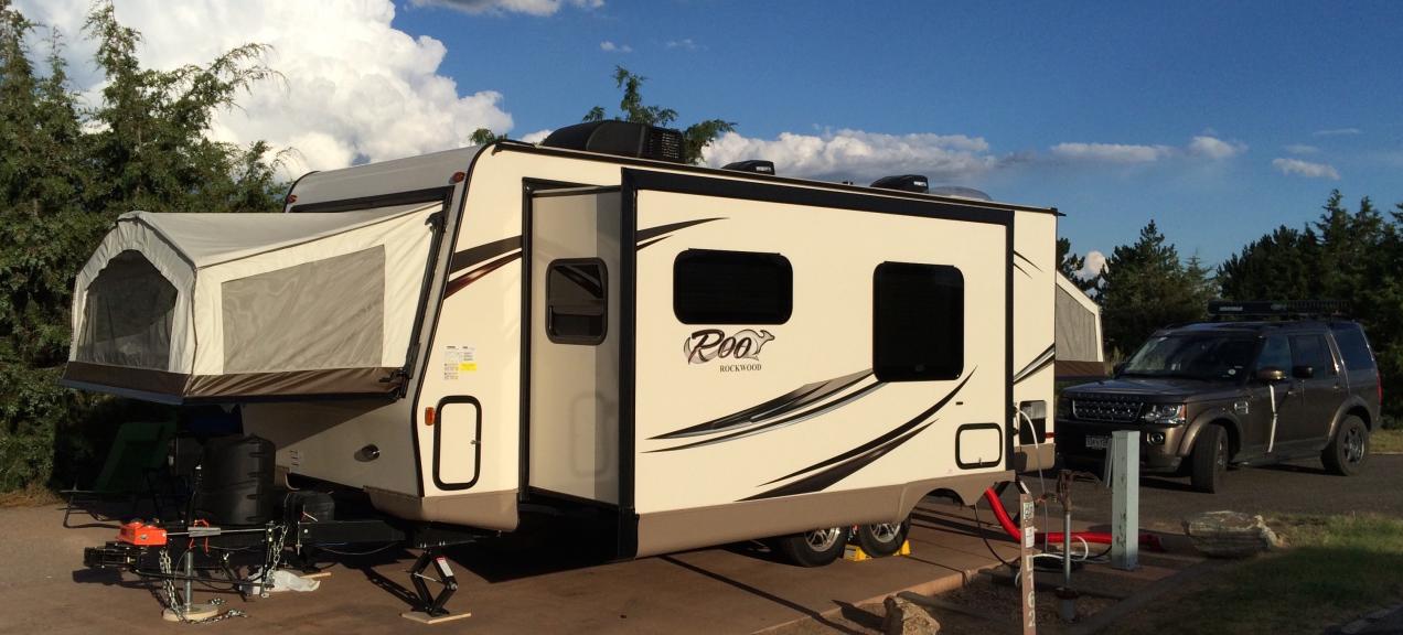

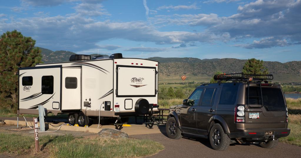

Here is what I am pulling. I met another LR4 owner on the Forest River forum for these brands that is pulling the same trailer. They also use a Prodigy controller. The trailer is about 5100 dry weight and a GVWR of about 6500 lbs.
