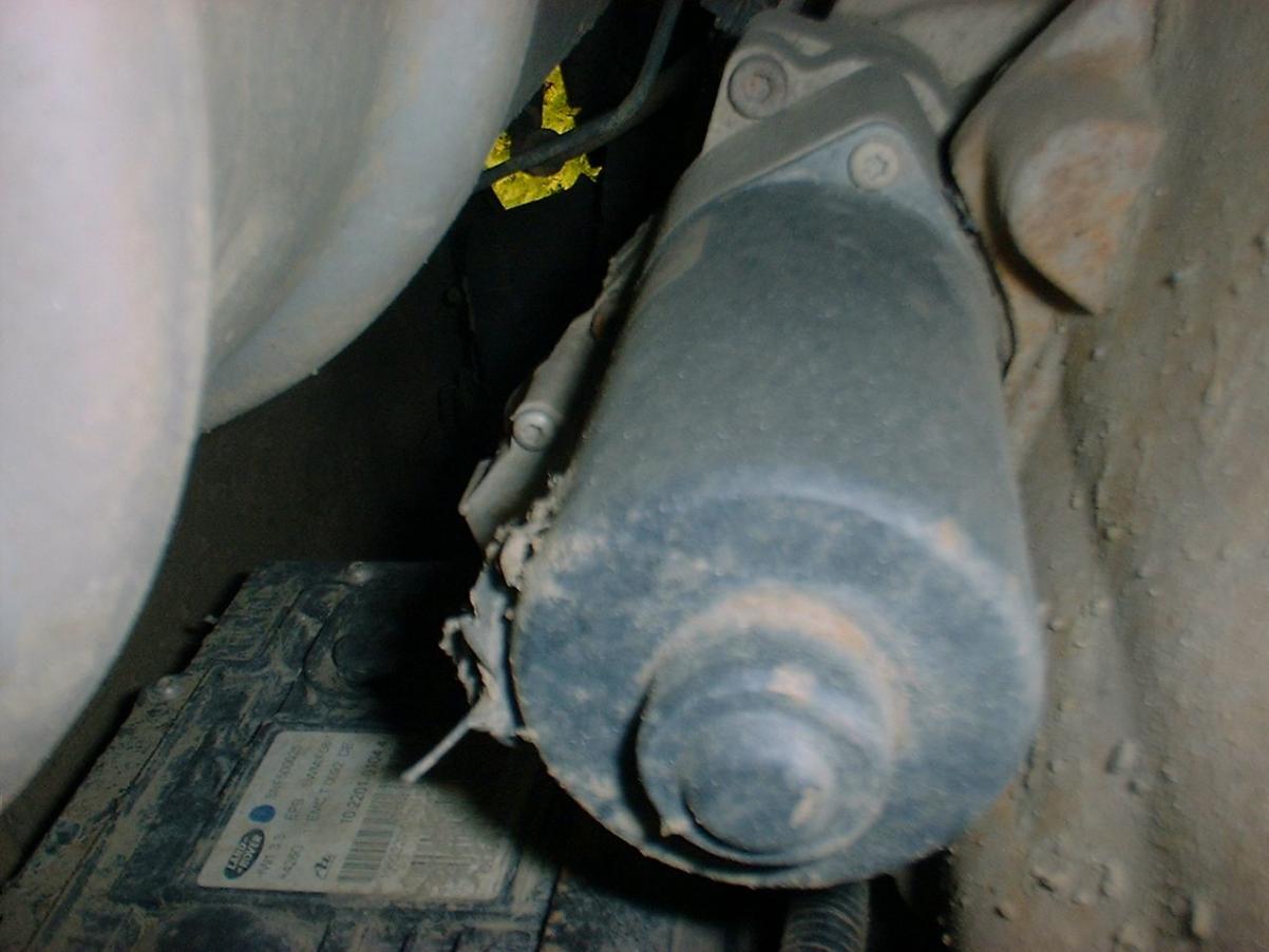

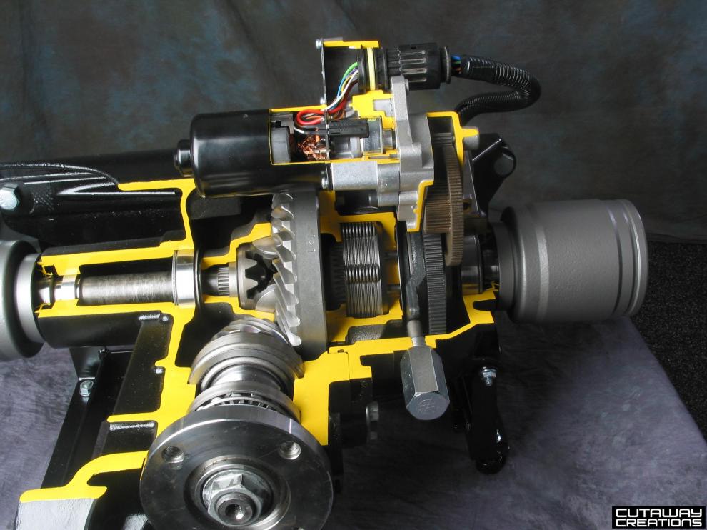

black round thing at the top
A few select 3's have an electronic sort of locking extra special rear differential package. The stepper motor that everyone is referring to is the sort of round black motor like bit at the top where the computer cables feed into. Yes, computer cables - a stepper motor is not what you see on your average electric locker. Land Rover is as usual, away head of the curve.
