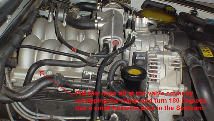

This is taken of the passenger side of the engine. Take the hose off of the valve cover, turn it 180 degrees so the opening is up, get a funnel that fits snuggly in the hose, start engine and pour about 1/2 of the Seafoam into the hose. Pour slowly because your engine will try to stall. Once half of the can is sucked-in. Turn truck off and let it sit for about 10-15 minutes. Start it up and watch it smoke. Do this in a well ventilated area. It will smoke like a toothless redneck. :bandit:
Edit: This is for D2 only...

I like the idea of pulling a vaccumn line off the manifold and attaching a couple feet of new line that is stuck in the SeaFoam bottle. I regulate the flow with a pair of needle nose pliers and us e the whole can over 5 minutes of flow, then let it sit for a half hour. Once you start driving try to get to a highway so you can really let the engine get up to speed.
The bad part of this though is that the smoke trail is pretty bad for about 10 minutes, but the results are worth it.
