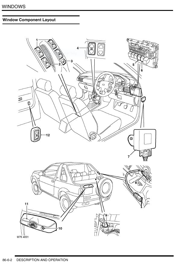

    Where is the ECU located?

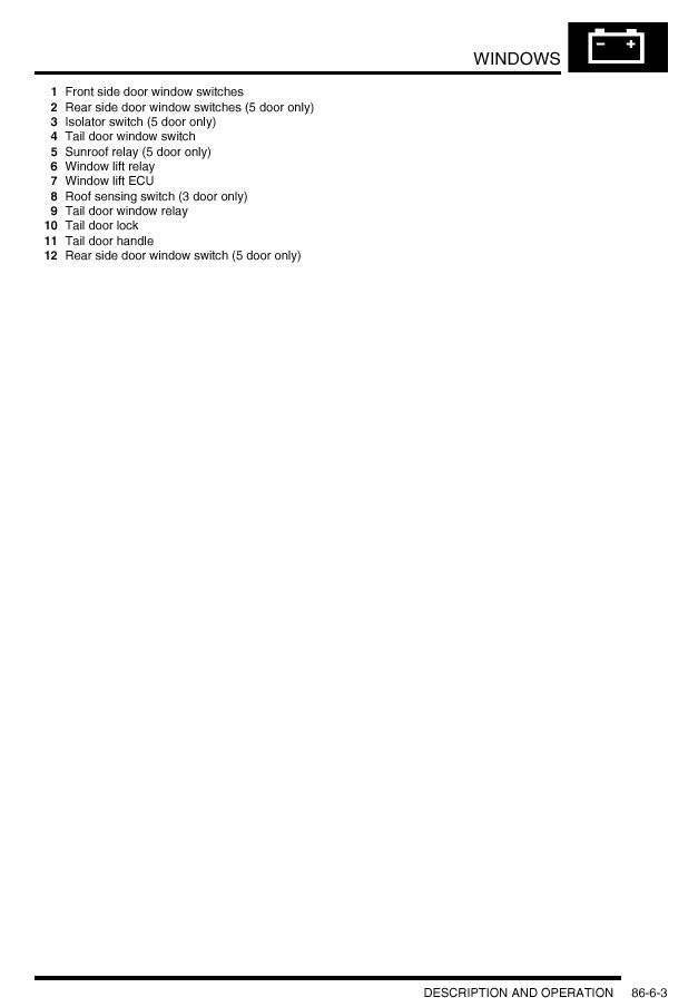

  4. joey
    Posts:
    9,694
    Likes Received:
    37
    Joined:
    Jun 28, 2004
