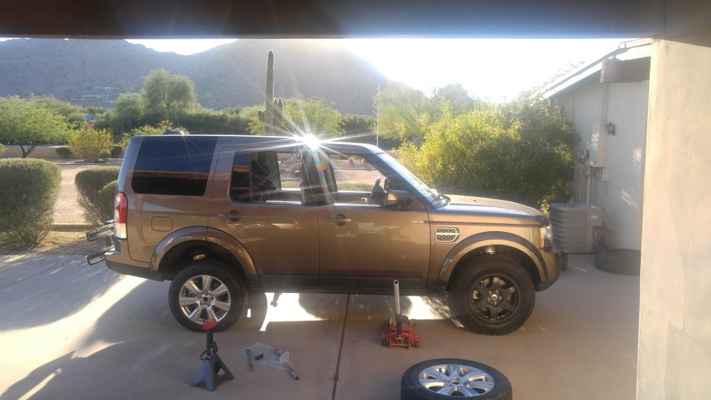

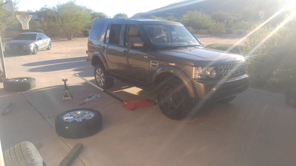

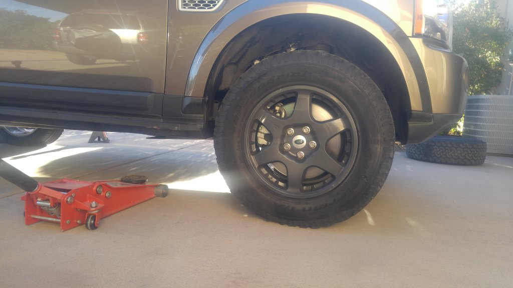

After recent balancing and rebalancing of my ,missing chunks of tread , BFGs I still had vibration on steering wheel and I decided to put my stock wheels and tires to find out what was going on. The good news is no shaking , no vibration.( I forgot how much lighter the stock set up is ;). The bad news is ...I will be buying new tires (KO2).( I thought that my wife could use stock wheels / for daily driving and I would just change to my abused BFGs for Off-road trips but this idea was not approved by her.:adore:
The pictures explain everything.
LR4 with 18 inch wheels and AT tires looks like a completely different car.
After 3 years with BFG I forgot how tiny stock tires were.
Couple of pictures included.

I suspect most of us on this forum like the front wheel more than the rear. ;-) Nice color LR4, BTW!
