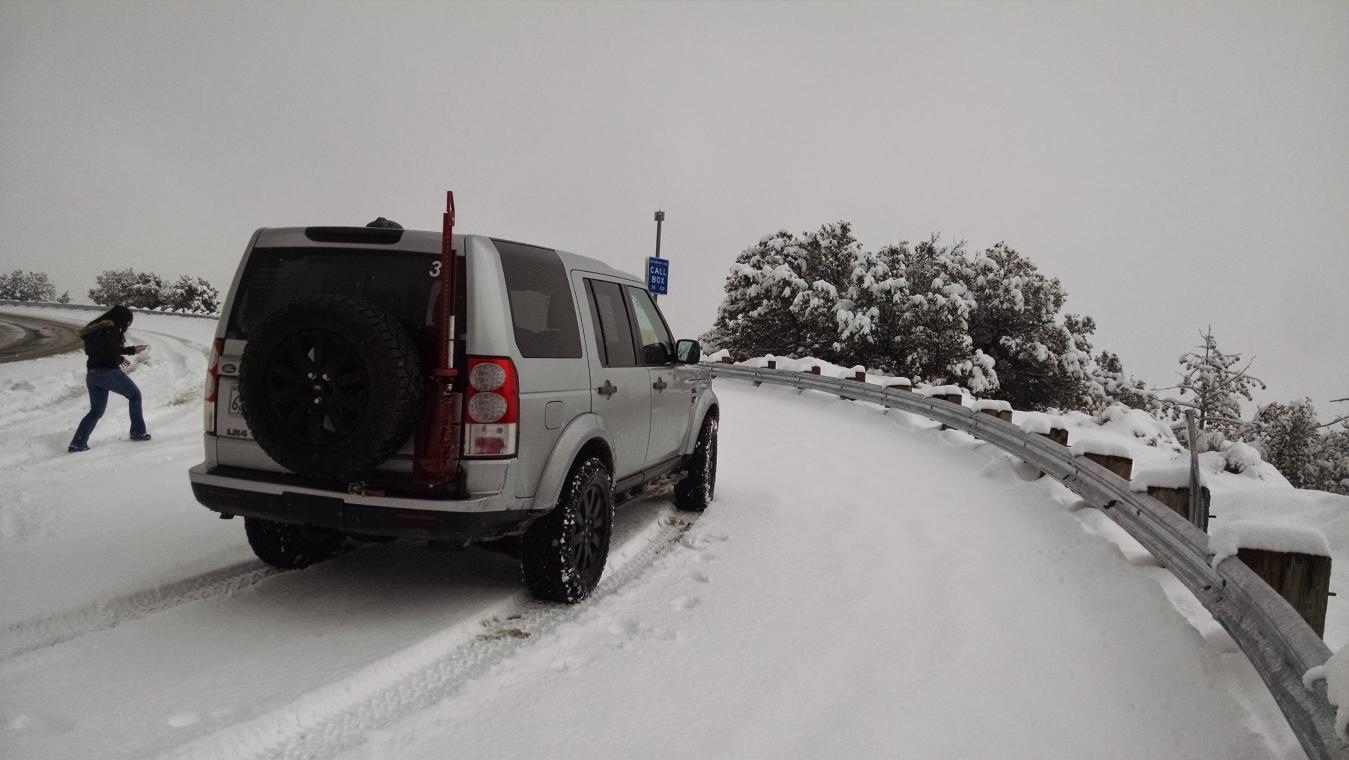

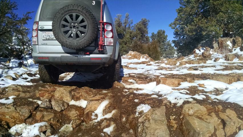

You can kind of see it in this pic. It is the black plastic looking thing between the spare and exhaust pipes.
