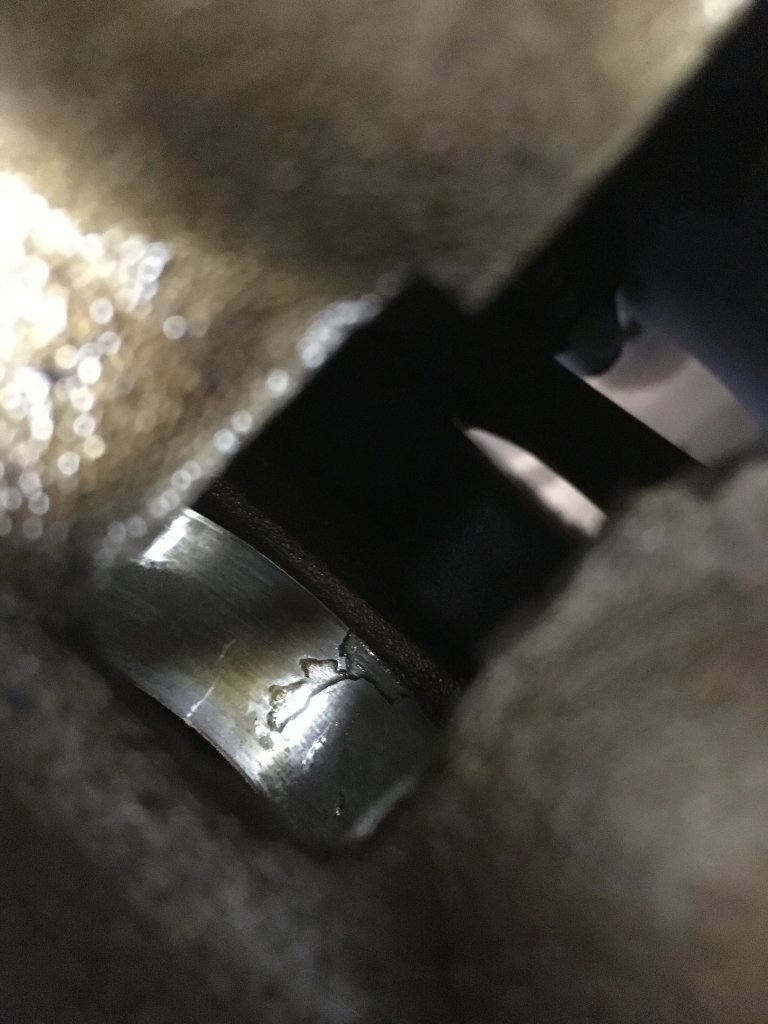

Here is a picture of the bad cam bearing

After reading 130,000 miles and "all the springs and valves. All was perfect". Those original valve springs have done their job and are sacked out at that many miles with less than the minimum closed spec seat pressures. Added shims to old springs is a bad idea.
The cost of new springs outweighs any damage from a dropped valve like a destroyed head, piston and cylinder bore.
Shimmed spring to get back new spring seat pressures at that many miles your playing Russian Roulette. On the bright side you can replace valve springs with the assembled engine, valve seals included.
Measuring each valve retainer to spring seat height then adding the proper shim thicknesses if needed to get the proper seat pressures of the cam manufacture's specs.
With your cam bearing (?) damage this would of been a good time to drop and clean the pan as well remove 2-3 random rod caps inspecting the top inserts for damage as well wear.
Another thing to think about, manufactured engines these days all have roller lifters and cams hence not relying on the now removed by the EPA zinc and phosphorus additives in the oil.
LR's flat tappet cams and lifters this spells a slow death to them especially during new cam break in which requires break in additives. Also recommended to run zinc and phosphorus additives in to your normal engine's oil for added protection.
The first DRY COLD START OF THE DAY or after an oil change is when the proper additives can help but better yet having a pre-oiler added to these LR engines.

Hi, I did the break-in with VR1 and acdelco zinc afdditive. Now I run liqui moly with their wear additive.
Agree many things have worn a bit but you have to draw the line. I was not there to make this a brand new engine and the engine was in there so I was not going to pull the crank. I have never had any low oil pressure warning at idle so I assumed my main bearings were still ok.
If the bottom end goes and I have to pull the engine I might do the Cummins route with 5sp manual :). If it’s going to be a big project might as well make it a proper big project :)

Congrats and I hope you weren't thinking of me as busting your chops replies?
On the crank, just checking and possibly replacing the rod bearings only, this an easy task after removing and cleaning the pan of whatever was washed down including antifreeze.
Do not rely on the "idiot light" as it will turn on below 10 psi like 7 psi at a lower than computer set idle. Add a gauge plus make sure the pressure relief plunger is nice and smooth as well the aluminum bore it sides into as the bore at higher mileage engines begins to wear away causing a sticking plunger. On using VR1 oil, run it at break in but not all the time as it will sludge up and varnish the engine like an engine that never had an oil change. Seen this on a couple low mileage engines the owners bragged about VR1 as the best engine protection.
