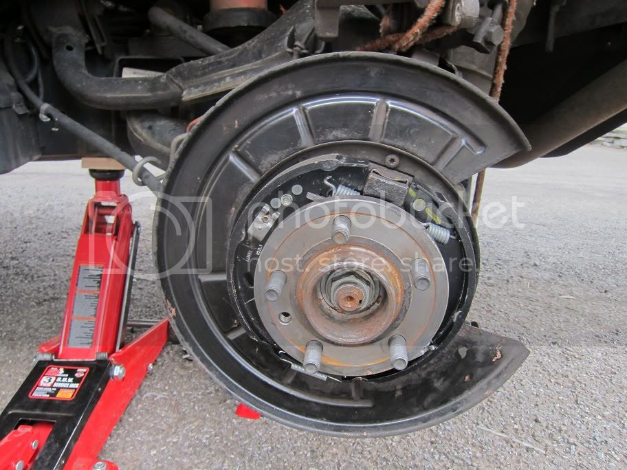

I started yesterday working on replacing the parking brake shoes. I started with the left-side first... as aforementioned the right side was giving me troubles.
Everything was going nice-and-smooth, up until the point that I had to connect the return spring on the new shoes. I've been struggling for over 4 hours so far. With the wind-chill it's 15-degrees outside right now, and I'm about half frozen to death.
I've tried every method possible to attach the return spring to the primary shoe. I've tried attaching it while the primary shoe was off, and then trying to pull the shoe down. I've tried pulling the spring over, when both shoes are mounted. I've tried everything all to no avail.
I'm in desperate need of help right now, as the temperature is going to be dropping into the single-digits in a matter of 2-hours. Not to mention, too, it'll be getting dark by 5pm.
I've attached pictures. (It's the left-side. The "return spring" is the spring at the top, which connects both shoes together.)
ryan-in-oregon
Jul 7, 2009
538
Its been awhile since I had mine apart however I "think" I put the return spring on first and then rolled the shoes on. In fact I think it is the only way to seat it in place. It is a PITA but it should go that way...
Trynian
Aug 11, 2008
836
Do you have a spring spreader tool for doing drum brakes? Having the correct tools can make life much easier.
