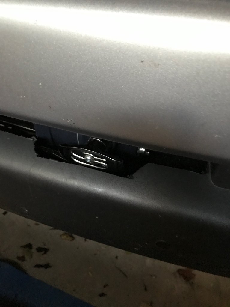

@geoffx19 -- Did you use the terrafirma mount? I have cut the plastic back around the top front edge of the mount and notched out the freespool handle (that I had to clock back to 9:00 because of the lack of vertical clearance. Do you have a photo or two you could post? It would be most appreciated.
ClearwaterScott
Sep 28, 2016
41
Missouri
This is a close up of the rough cut I started for the handle. I will take another pass with the grinder and then use hand file to smooth and even it out.
