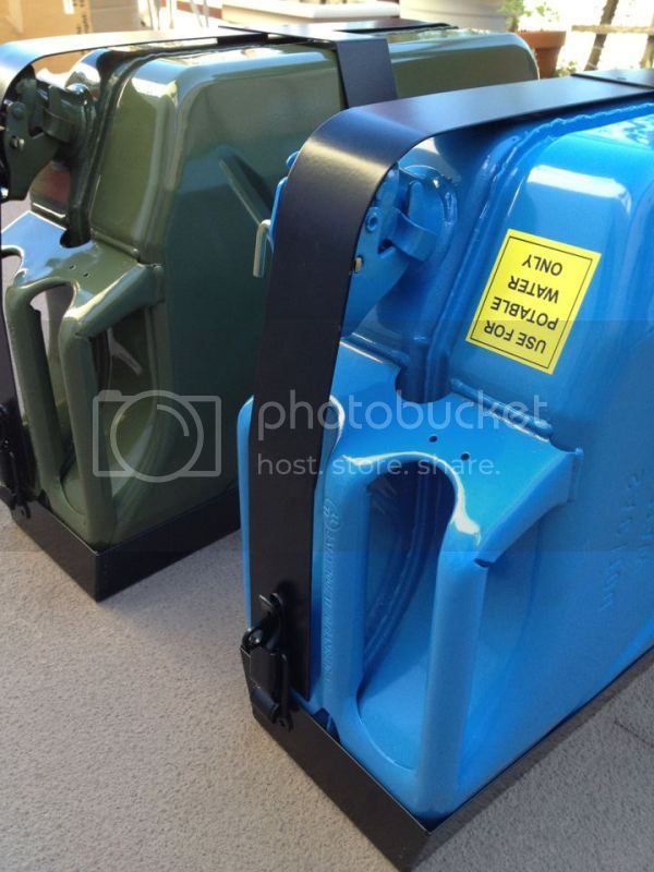

Hi David,
If it were me, I'd plan on leaving the poultry floor on all the time. It will make loading anything easier. I would attach the jerry can holder to the poultry floor with a bolt through each of the two holes in the base of the holder, through the poultry floor, and then backed up by a big fender washer and a Nylok nut. I've not done this, and I might test it before heading out on an expedition. If I had any worry that the two bolts were not enough, I'd drill 4 new holes in the base of the jerry can holder and secure it with 4 bolts. The standard two-bolt hole positions on the jerry can holder allow bolt heads to lay within the recess that goes all the way around the jerry can. If I used four bolts, I'd make sure they were flat-heads and countersink the holes that I drilled. My bet is that two bolts will be fine, though.
As for overlapping vs. non overlapping, that kind of depends on the particular measurements of the rack. Ideally you would want all the edges of the poultry rack to be supported. If that's not possible, I'd go with the overlapping. I think the non-overlapping would have a cleaner look.
HTH.
