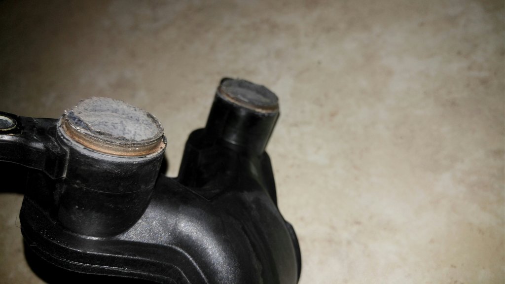

    This is my crossover pipe story.
    About 2 minutes form home low coolant message appeared. AC became weaker. ( outside temp was 106*F. ) Parked the truck in my garage , got out of the car and I could smell burning coolant. At the same moment coolant started pouring down on the garage floor. Lost all the coolant in half a minute or less.
    I would be furious if this happened on the road.
    Pure luck it happened this way and the car did not overheat .
    Towed my LR4 to Land Rover shop and off course it was this stupid plastic crossover pipe with Ford Motor Company logo on it. I was told that it was a common failure on LR4, but usually at 80,000 miles. My truck has about 54,000 miles. ( 2013).
    It was fixed and everything is fine now. In an ideal world Land rover should pay for or repairs related to failure of Fo Mo Co plastic pipe.
    This is a very bad design and consequences of its failure very scary and expensive . I was just lucky this time.
    I am putting this crossover pipe on my list of regular maintenance items . ( not waiting another 50,000 miles for it to fail).

    So what was it replaced with? Aftermarket pipe or the same plastic coolant pipe from Ford?
  8. TLB
    TLB Full Access Member
    Posts:
    273
    Likes Received:
    17
    Joined:
    Feb 11, 2011
    I asked if there were any aftermarket crossover pipes ( especially not plastic) but was told that nothing was available. So,my crossover pipe was replaced with a new Fo Mo Co part.
    Anyone knows about other options?
