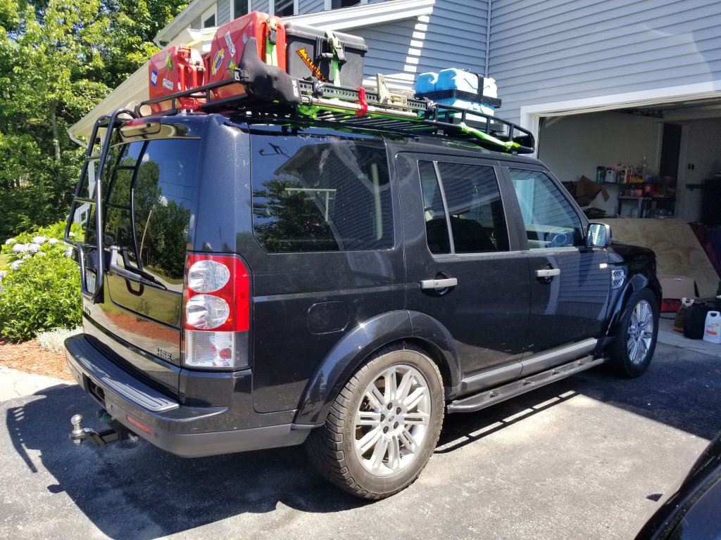

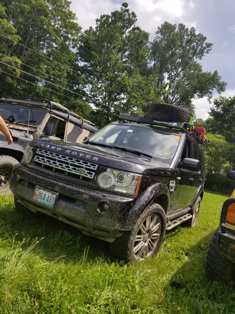

    I run a set of 285/50r20 Cooper Zeon LTZ. Great tire on and off road.
    I got almost 45K miles out of the last set, with proper alignment and scheduled rotation.
    They did run at the beginning, the first 4-5K miles.
    They do hurt fuel, but lets be honest its horrible to begin with. Another 1-2 miles less per gallon doesn't change my expected fill-up interval.
    I do have a full size spare, deflated to 18PSI. I do keep a compressor in the car (part of my emergency kit anyways)
    However, the added sidewall protection, aestetics, go anywhere ability are all worth the cons.
    Try pulling off the beaten path in the original Conti 255/50r20... wont make it far. Been there...embarrassing ;) 20170726_114832.jpg 20170728_114942.jpg 20171225_154553.jpg

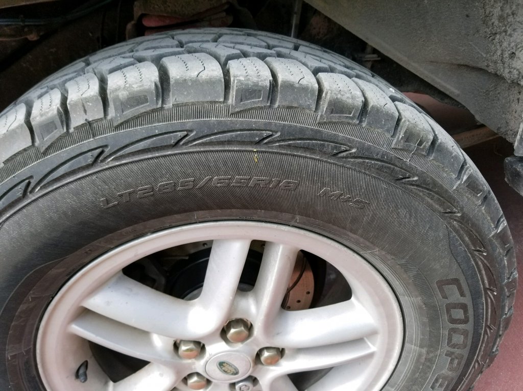

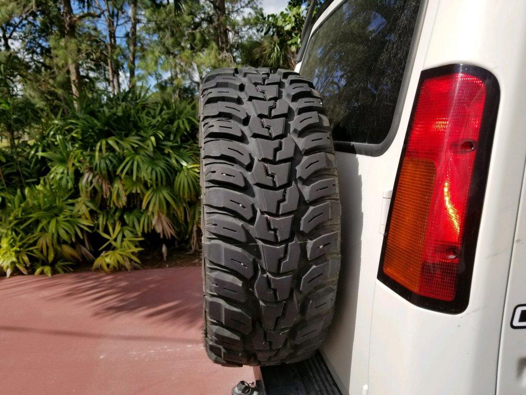

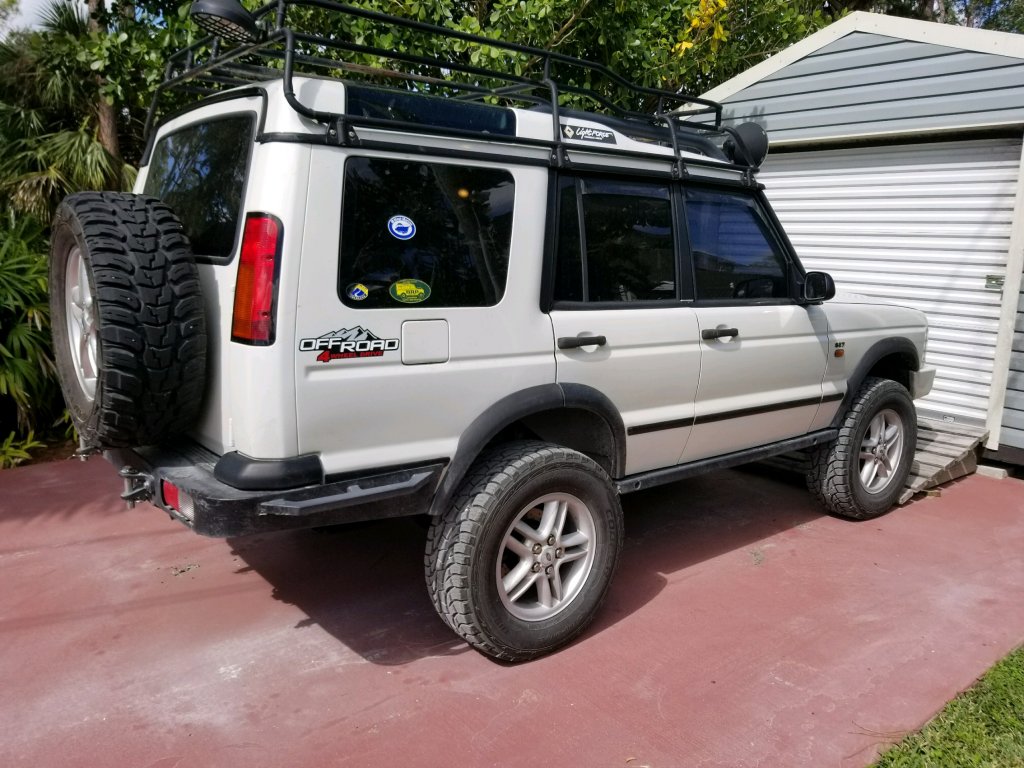

    I'm running Cooper ATP's on my Disco (285/65/R18) and really like them. 2004 Disco PS.jpg Also have a 2nd set of Hurricane Wheels with 33x12.5 Khumo MT's. I wouldn't hesitate to get another set of Coopers, but i want an E rated tire on the LR4.
