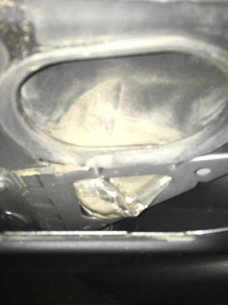

*edit* never mind. Noticed it was on drivers side as well. Must be the Brits way of insulation and sound deadening
Plasti dipping side vent grill. Upon removing passenger side vent I noticed odd insulation type packing just under the intake inlet/hose. Is this normal?.. truck has a clear carfax. Sort of worried this is hiding something or someone has done a lazy job at fixing a drain issue. It's a plastic wrapping with foam or something inside. Anyone who has dipped their vents have it?

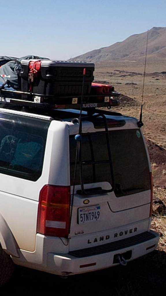

Ordered a Cobra75 CB today with a 4' Firstik antenna. Running the coax to the rear under the panels/carpet, and mounting the antenna, grounded, to the tailgate next to the tail light. Not sure who owns this rig, but a similar setup. I plan on using it primarily for group meets and trail use. Anyone else done a similar setup? Rendering up ideas for the mic placement/mount. I would like the radio itself to be tucked away. My JL amp the subwoofer is mounted under driver seat so it won't fit there. Next best guess is possibly behind the center console.

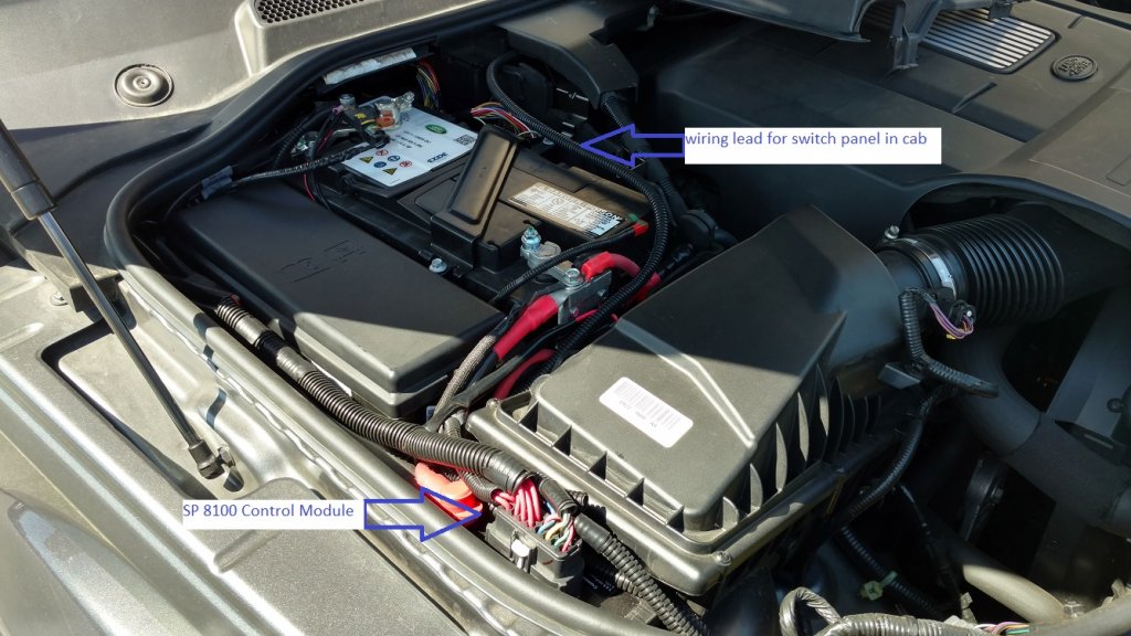

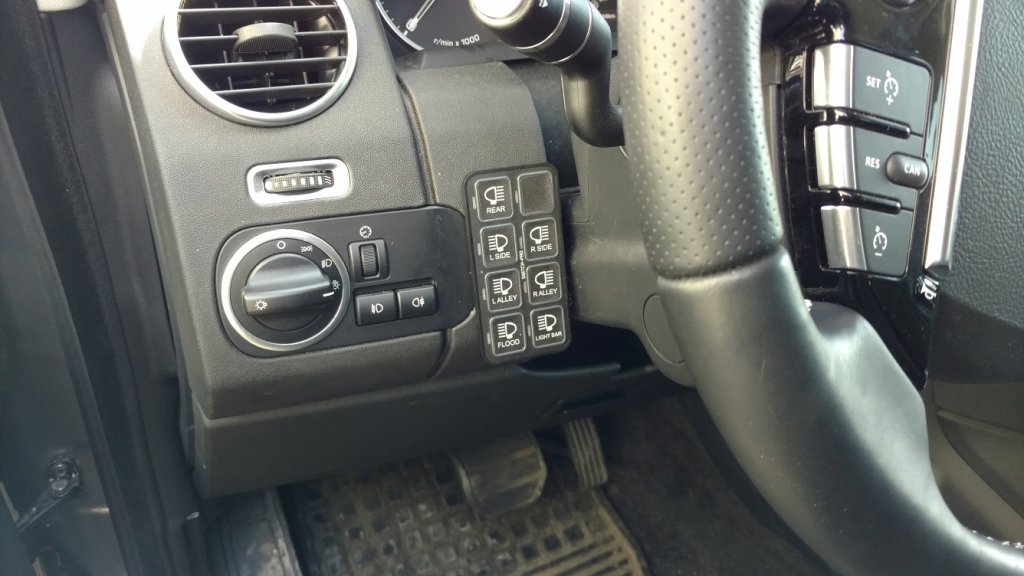

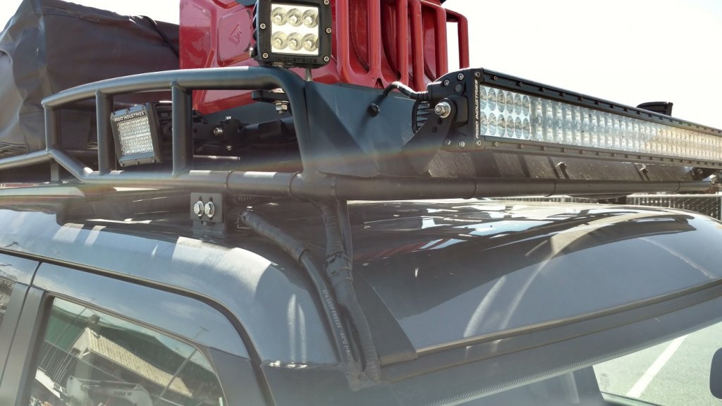

Finally finished with my auxiliary lighting project using Rigid LED lights and Switch-Pro SP-8100 programmable switch system
light switch mounted
Location of control module and associated wiring
Wiring harness routing for roof rack lights
http://www.rigidindu...-lighting/54461 mounted on a custom stainless tab in front of the grill
http://www.rigidindu...-lighting/14231 mounted on the rack
http://www.rigidindu...lighting/104512 pair of these mounted on each side of the rack
http://www.rigidindu...-lighting/50111 pair of these mounted on the rack aimed 45 degrees from front
http://www.rigidindu...-lighting/91251 pair of these mounted on rear of the rack for additional backup lighting

What in the holy hell are you trying to light up!?!?!
I feel way under luminated, with just two front (Mounted to the ProSpeed bracket)37W LEDs, and two rear 18W LED's
1,694
Unless you want to run your engine to keep the power flowing... why would you want high wattage lights, especially in the back.
I prefer my 18w lights in the rear because I can run them on the aux battery for a long time without draining things too much. Its plenty bright to work or setup camp. Lights up a huge area.
