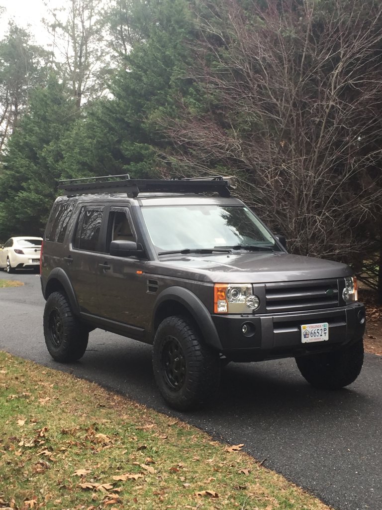

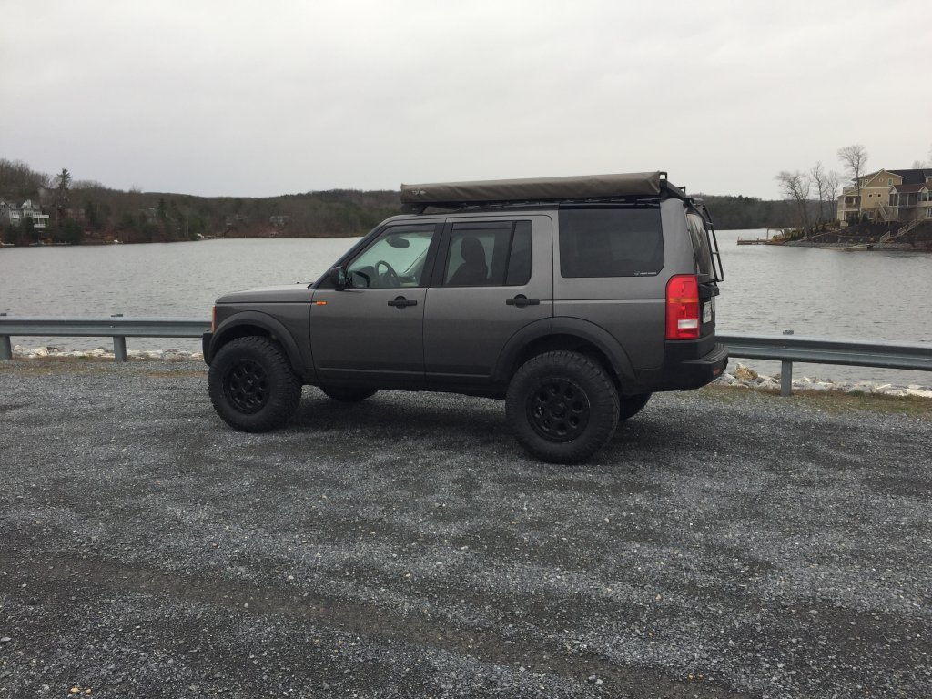

Lucky 8 actually stepped theirs up to 35s, which is nuts. I put a 1.5" wheel spacer in which helps a ton so not too crazy on the hacking. Really just extended the wheel arch further back by about 2 inches on the front. The front bumper took significant trimming. You'll have to relocate the washer fluid bottle OR if youre smarter than I am and did a front bumper FIRST, there would be nothing to trim on the bumper side. For the rear, on the passenger side, you will need to re-route the coolant lines that run under the rear wheel well. Not too terrible to do. Other than that, no issues on the rear. Since it compresses down up and back the rear sinks into the wheel well fine.How?! @grimmecm Ive seen Lucky8 stuff 33x12.5 grapplers under their Disco3, but never 34's. How much did you havd to hack away? What wheels are those?

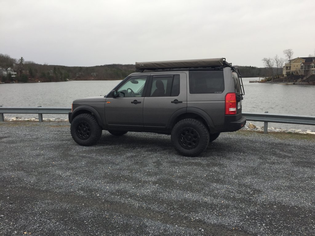

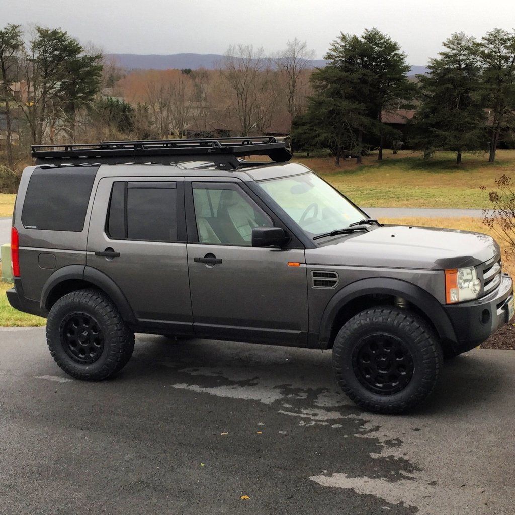

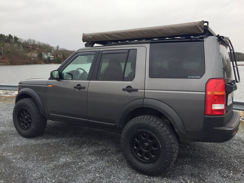

turns out 34"s fit... with some massaging...View attachment 6946 View attachment 6947 View attachment 6948 View attachment 6949
