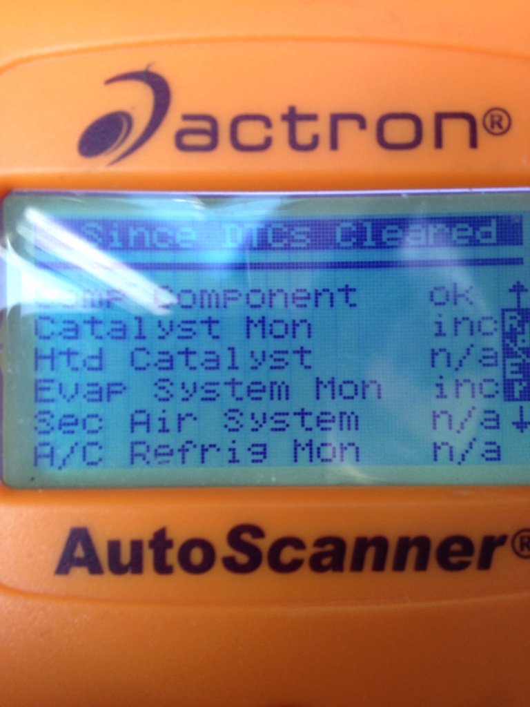

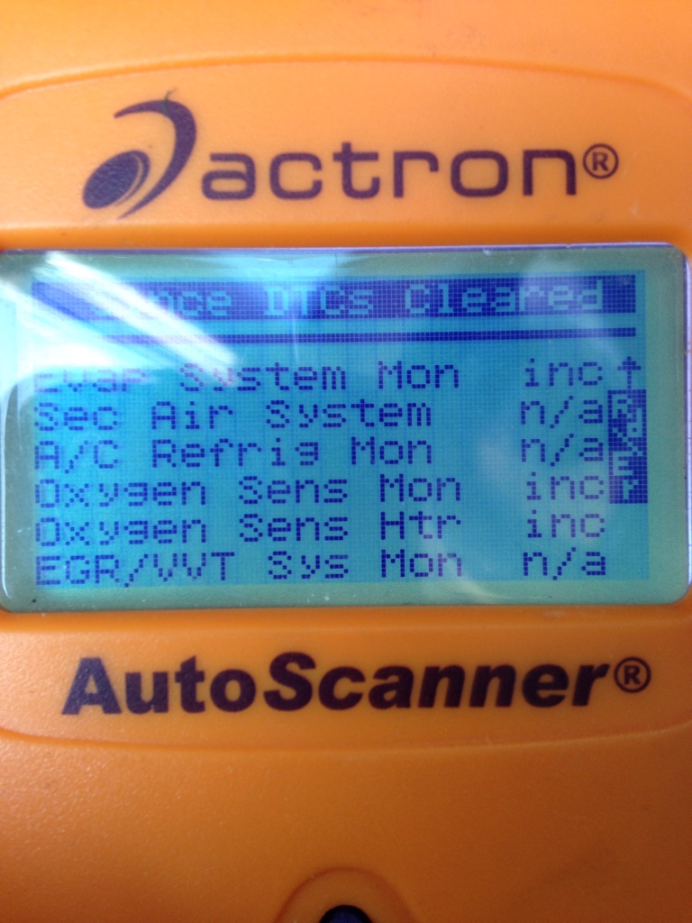

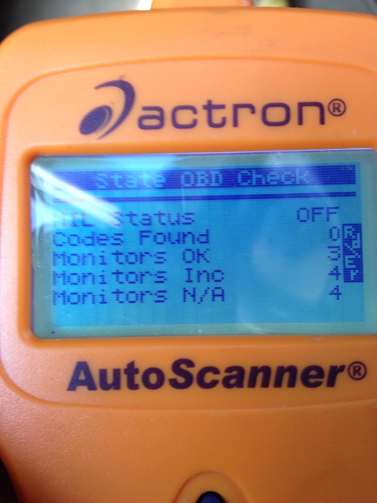

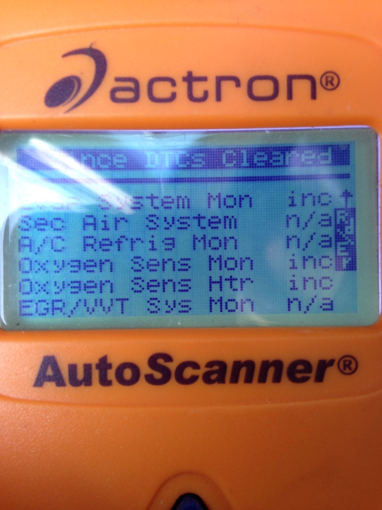

I just replaced the bad o2 sensor now this is what it is reading

States and county's may vary with what will pass. In WA I think you can't have 3 or more incomplete systems. N/a doesn't count. So I don't think this would pass in WA.
You may have to drive around longer till the computer can check those systems and report them as ok.
Bring in your receipts for the O2 sensors just in case... that may help.

Our smog is a machine that just plugs into your obd connector. The computer automatically reads it and decides if u pass or not

Got it fixed two new o2 sensors smog passed
