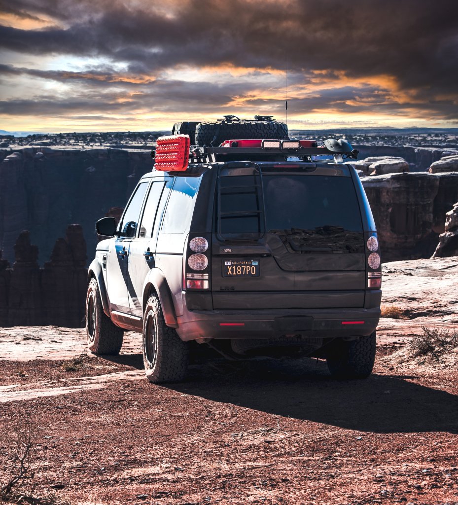

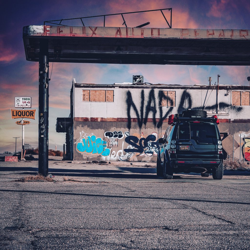

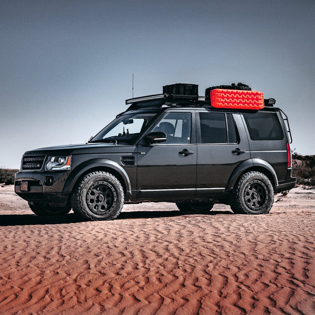

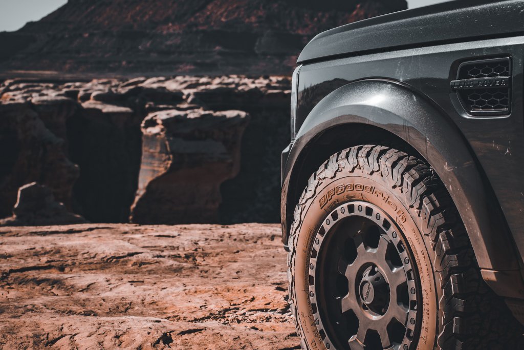

We just hit the 1 year mark with our 2014 LR4, which is also my 1 year mark as a Land Rover owner. So far we’ve been pretty fortunate, having bought the truck with 75,000 miles and no warranty.
We’ve put 10,000 miles on it (all adventure, we don’t commute and this is our third vehicle anyway, purchased as a “toy”).
We’ve been to Death Valley, multiple trips up to the Sierra Nevada (to include Coyote Flat), we’ve done White Rim Road in Canyonlands National Park, Zion National Park, we’ve spent countless hour exploring dark fire trails in the rain in the Sequoia National Forest, driven through a blizzard in the Tahoe National Forest, been through Yosemite, slept in it on the side of the interstate and in the middle of nowhere.
In the next month we’re doing Joshua Tree/Mojave and Grand Canyon (North Rim). This summer would like to do PNW and maybe a trip down the coast of Baja.

What’s your IG account, @cjm41 ? I’m sure I’ve seen and liked your photos there via my @districtrover account. Nice shots and good luck tracking down the issues you reported.

Those have to be the some of the best Land Rover pics I've ever seen! In regards to the fuel smell it may be related to the fuel tank flange recall. It can sometimes throw a CEL but most of the time it doesn't. I would check this if you already haven't NHTSA Campaign Number: 21V635000.
