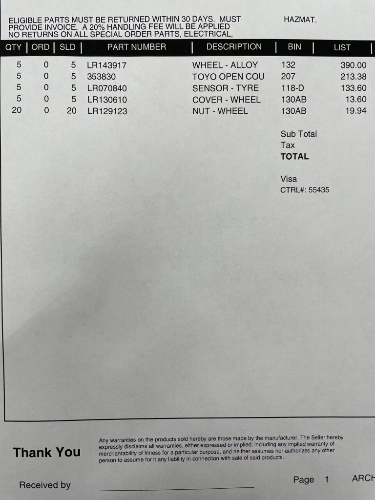

Yes, the trick is you have to have a Vin of a new Defender with a 4cly engine or you can’t order them.
Here is a list of the part numbers and quantity. View attachment 12194
bumping an old thread....Hi OP - the rig looks awesome with those steelies. congratulations!!
I'm in the process of doing this myself. got a sample wheel to mount to see it if does and it does. I have the wheels, lugs n hub caps. I'm kind of stuck on the TPMS sensor issue. Part # LR070840 listed in your receipt - is that the one that's compatible with the LR4 software? When I spoke with the parts guy at my local dealership, he is of the opinion that the defender steel wheel compatible TPMS would not work on my LR4 (2013). according to their listing for my VIN, my 2013 LR4 has 315Mhz TPMS and not the 433 MHz TPMS. I'm not opposed to using the TPMS from the original alloys (19") in the defender steelies, just do not know if they will fit and seal correctly on the steelies.
Any inputs from your end?? Thanks in advance. I'll post up pics once mine go on the truck.

I just went with rubber valve stems and deactivated the TPMS. I'd like to find some TPMS with the rubber stem as the silver stem just doesn't look right on white steelies, in my opinion.
deactivating the TPMS would be the last resort for me if nothing else works. I share the LR4 use with the wife and as such would like to retain the TPMS functionality.
i'll probably have the tire shop take off the TPMS from the original alloy spare and see what frequency it runs. the silver on white is not nearly as noticeable to my eye.

Back to your question, your LR4 does have 315mhz. They changed in 14, I think.
interesting. If that is actually the case, I wonder if the generic TPMS that discount tire has will work since their's is of the 315Mhz frequency (I confirmed with them). I would rather have TPMS in each set of wheels rather than having to swap as long as it fits and seals correctly. More to ponder I guess.

Discount Tire's did not work for me a few years ago when I bought a new wheel for a full size spare. I think they wound up having to use the Land Rover sensor after trying a few of theirs.
