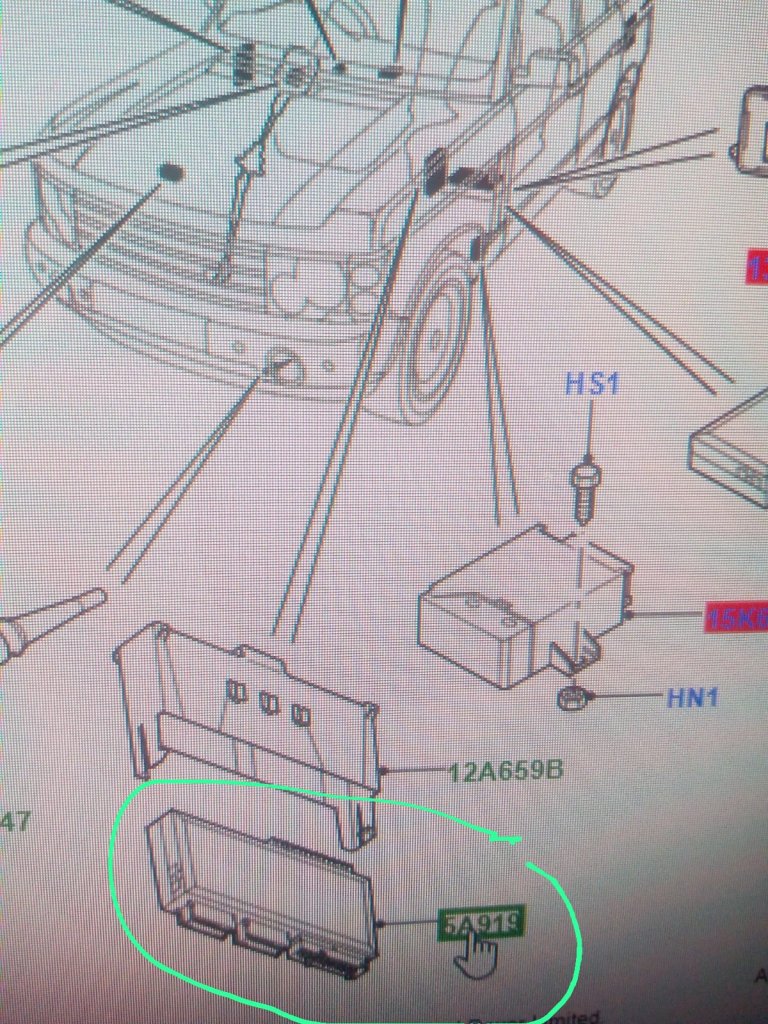

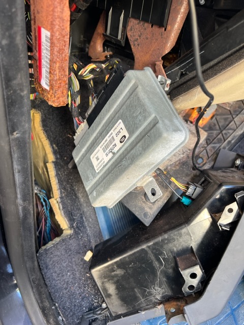

Can anyone tell me where to find the ECU for the suspension on my RHD 2006 L322 please. I’ve not been able to find anything by Google and the best I got was the vauge diagram attached which makes it look like it might be alongside the passenger seat. Have had all the footwell panels off with no success finding it’s white box and reluctant to do more disassembly without having an idea I’m in the right place. Thanks

It's on the left side front foot well area. Mounted vertically. It is an aluminum case, about 6" x 4".

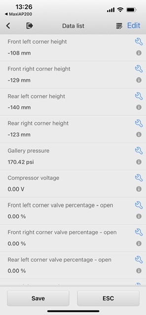

The reason I’m trying to find it is I have the problem shown by the screen cap. Reservoir at pressure, all four corners down and should be demanding air but one of the valves is open. It’s an intermittent problem so they do open occasionally and pump everything or some of them up but then they’ll drop again and not reopen. If its up it will stay up parked for days without dropping even 1mm so don’t think its the airbags. It’s just they are not getting pumped up most of the time.

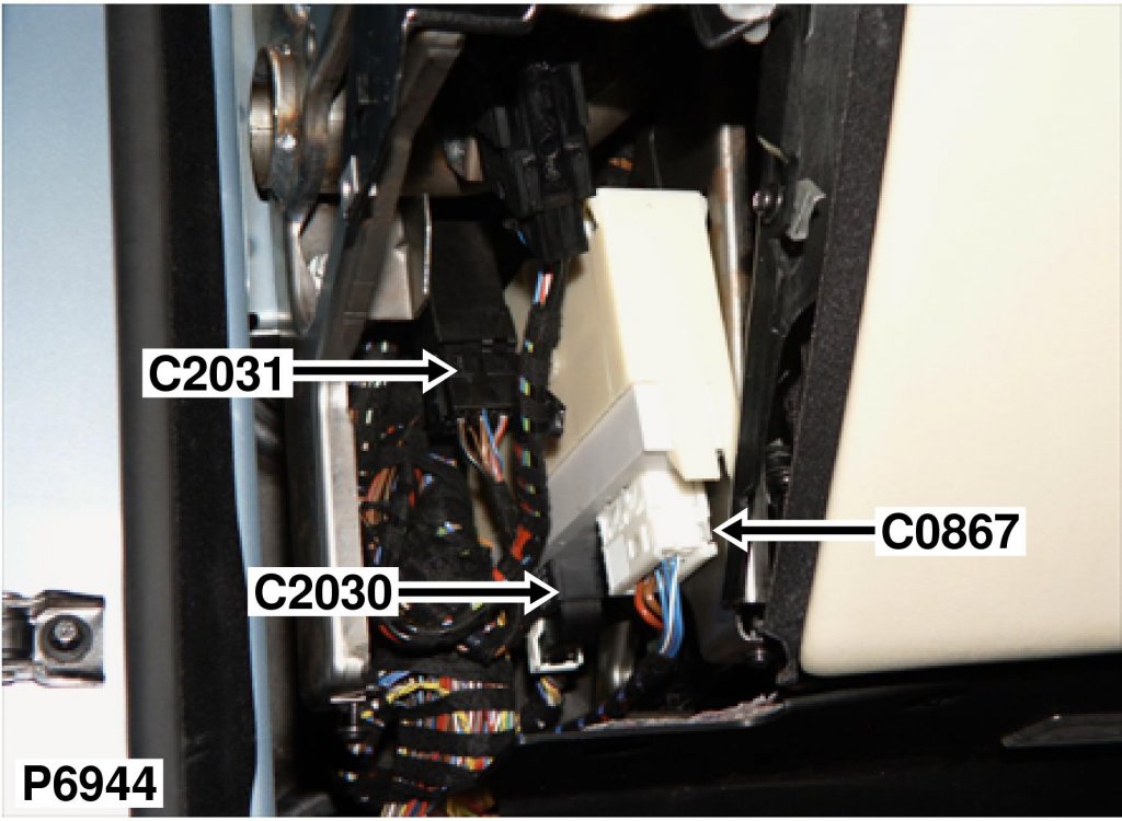

Ok. It is a white box. Mounted on the dash itself. Between the glove box and door opening.
