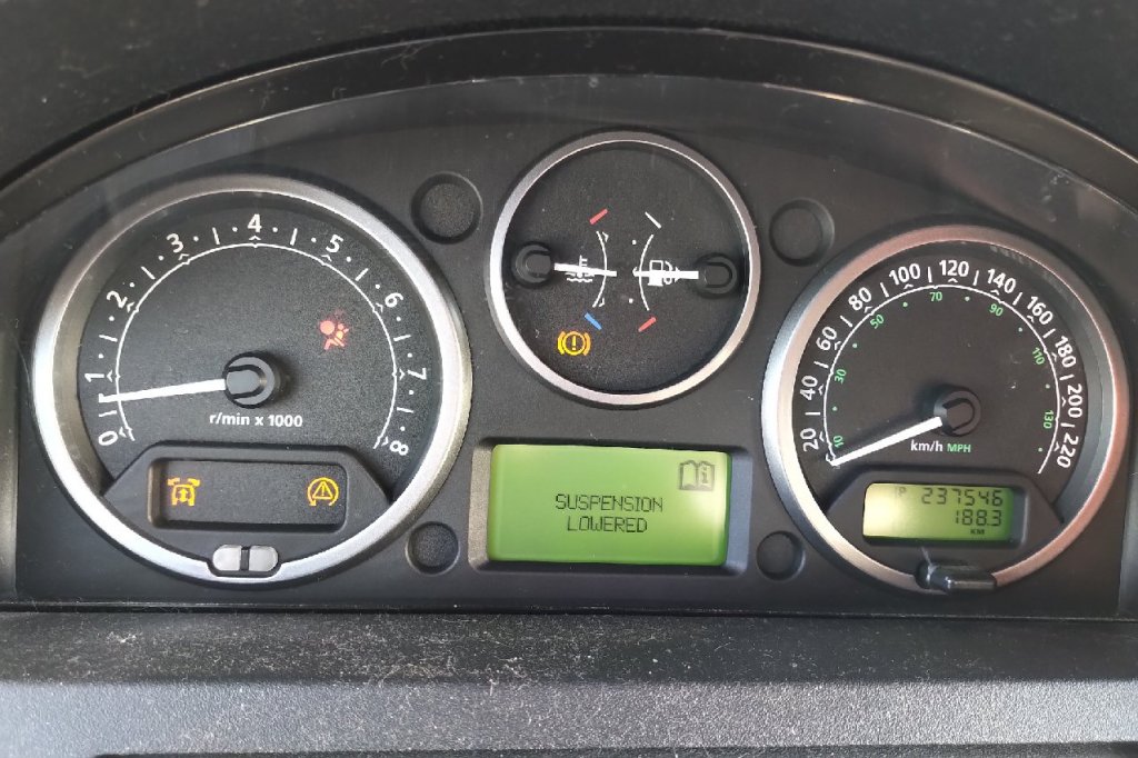

Vehicle started fine this morning, but got a series of dash lights...see photo.

Did you try installing the cam position sensor yet? Also, the lights in the photo is referred to as the "three amigos" do a search using the Land Rover LR3 three amigos and you should point you in the right direction

Thanks for the input. I'm aware the the dreaded three amigos. I've had them before and they usually go away when I restart, as they did this time. I 'haven't had an issue with the vehicle not "catching' since this post. However a few days ago I got the P0340 code, cleared it, and haven't gotten it again. I haven't tried the sensor yet, it's on the front passenger seat ready to be installed. From what I can see it should be pretty easy.
