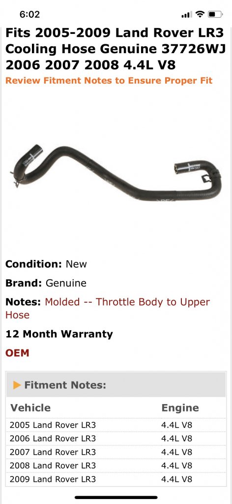

    I had a small hole in both the coolant hoses coming out below the throttle body. Replace one hose and cut the bad end off the other.
