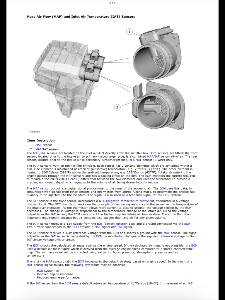

Well, some may disagree but I would want matching MAFS.
Are you throwing codes?
Though its for a different engine, its the same principle…
Note the section on “not plausible”.

Correct,
It is one tb but the ecu will be seeing wrong total volume of incoming air. Either 25% more or less than actual depending on which maf is accurate...no?
Maybe the 02 sensors added, it can figure it out...but still cant be 100%?
