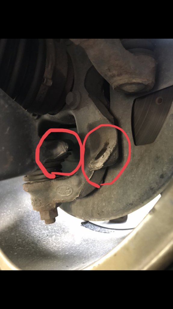

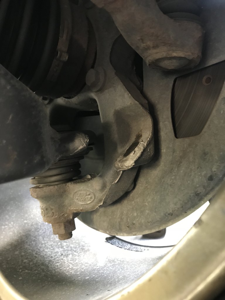

    E18D524E-B50D-4515-B098-30D0E45A699A.jpeg I had the EXACT same noise only would happen while backing out of my driveway. I brushed a little anti-seize on the 2 spots and haven’t had a issue ( it’s been probably 10,000 miles and quite a bit of mud sand and flooded roads) sorry for the crappy pictures. Hope this helps

    Thanks! This is helpful. Can you circle the spots on the image where you applied the anti-freeze? It’s hard to tell where I need to apply it.

    Yeah sorry here the pic. And the stuff I think lasts the longest is the silver paste, not the copper one
