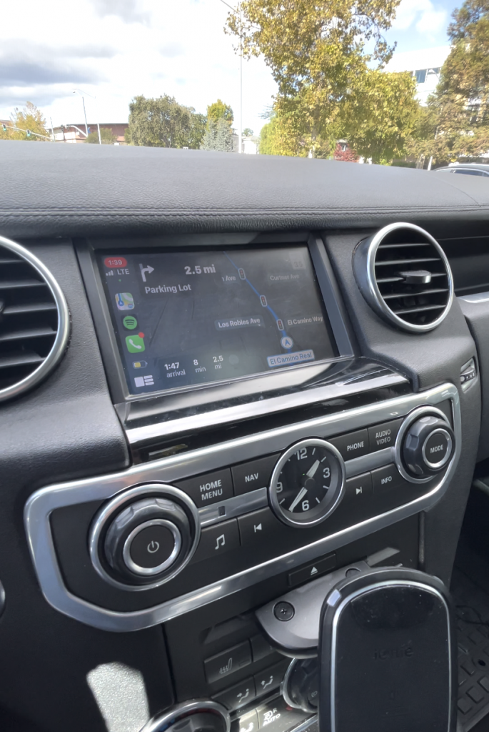

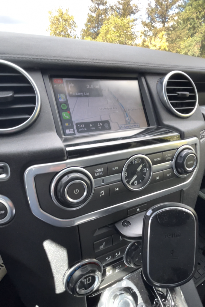

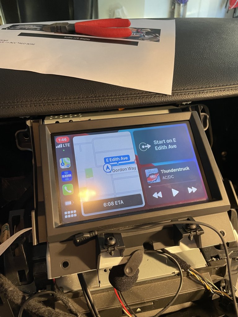

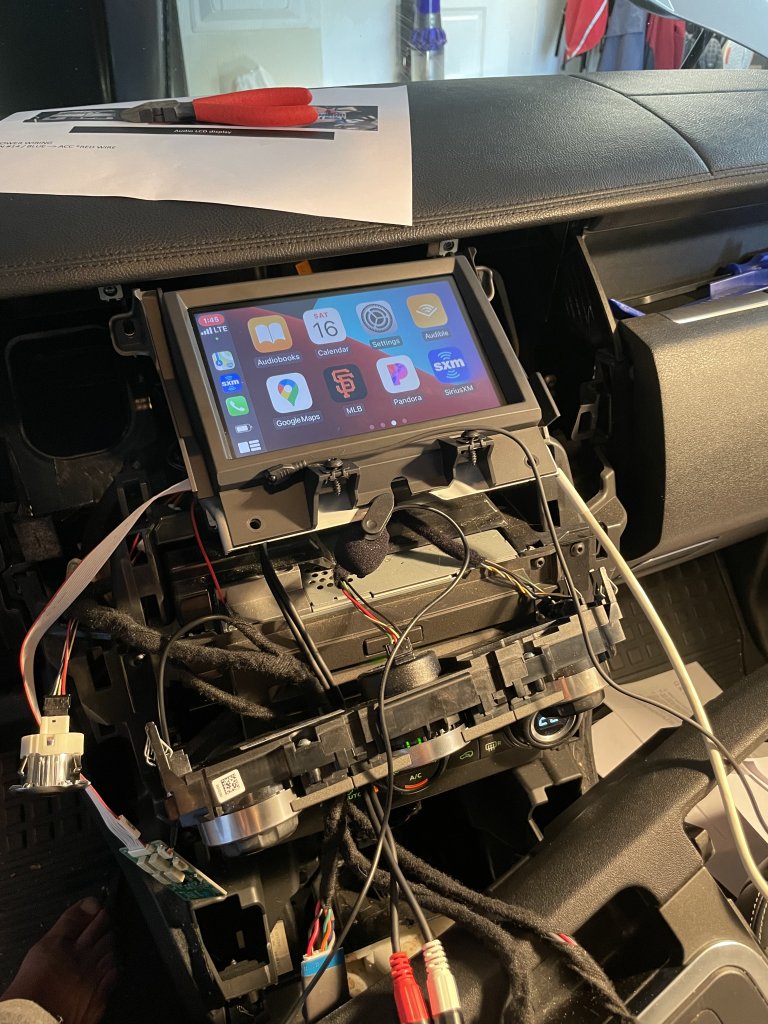

I just finished installing the NaviPlus (Australia) CarPlay system in my 2011 LR4 and it works GREAT, with one exception. The component that provides the wireless connectivity is always on and runs the battery down. Documentation is not great, but NaviPlus support was excellent with my few installation questions. They just showed me how to re-wire the power connection into the AUX feed so they unit will fully shutdown when the doors are locked. Looks like a simple wire cut/splice with minimal soldering.
I would say the installation was hard, 7 out of 10, and not for the faint of heart as you have tear apart the entire console and solder a wire (or two) and then figure out how to place all the components and 2 circuit boards back into a small space. But well worth it!
You must be registered for see images attach

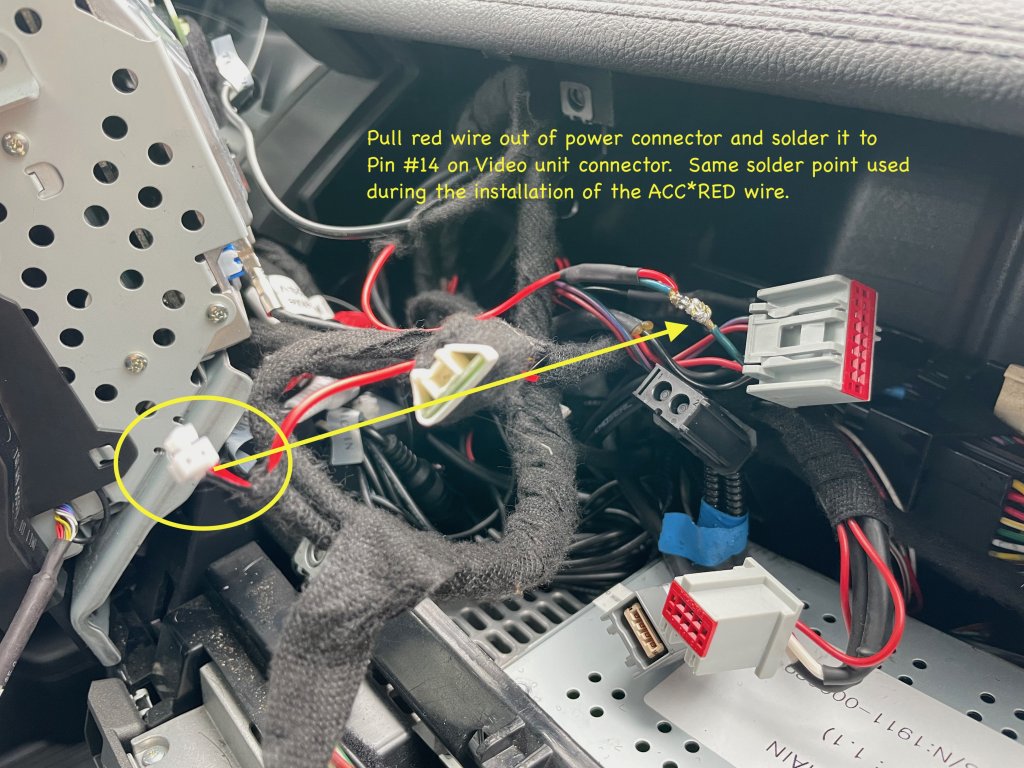

This should *hopefully* allow the NaviPlus system to fully power off when the doors are locked...
Quick update. I just finished reconnecting the power lead to the ACC connection on the Video unit connector and it solved the "always powered on" issue. WiFi/Bluetooth NaviPlus/Carplay signals go off when the doors are locked.

You simply hold down the NAV button for a short time and the CarPlay interface comes up. Autoconnect works great. Also has an auto night mode that will turn the CarPlay interfaces dark when the lights come one. To activate this, I just had to solder the ILL wire from the NaviPlus to the interior light wire going to the start/stop switch. Handy to make the map easier to read at night. I couldn't find any distributors in the US, so I ordered directly and did the install myself as I couldn't find any local dealers who were willing to install it based on my "old" 2011 LR4. I found an installer that would install a different system, but it needed a 2012 or newer car :(. However, I'm glad I went with the NaviPlus as I like the features and operation better that some of the other systems out there.
Highly recommend if you can stomach the install. Requires 3 solder/splice connections (2 power cables to ACC wire on the original LR4 Video screen connector, 1 for the dark/night mode). Other than that it's just a tedious take-apart job, taping 2 small circuit boards in place, and cabling up the 2 boxes supplied in the kit. Then figuring out how to run all the cables and fit the boxes back in place.
