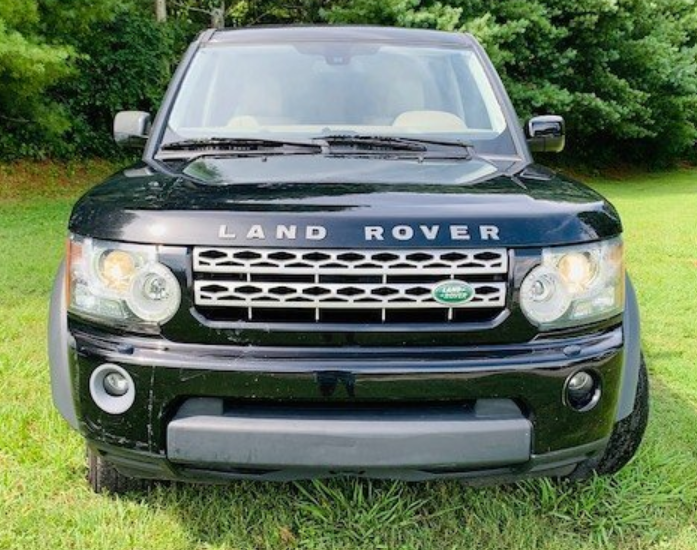

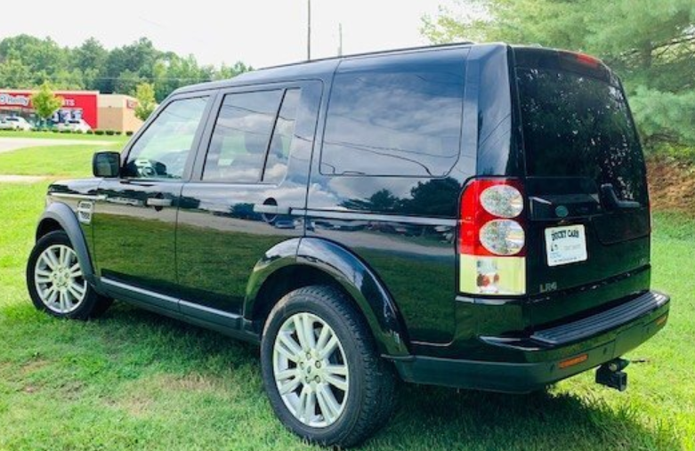

Also, pics??? What service records do you have? Good luck and welcome!
Thank You! Only records are the original passport to service entries up to the 25k service. Pics attached :)
