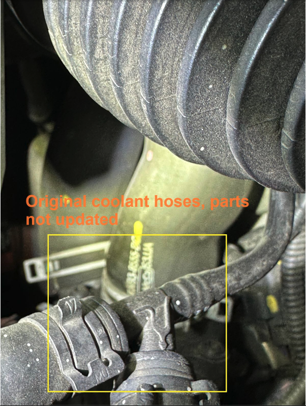

2011 LR4 with 130K miles.
Had the front X-over and water pump done at 80K miles. (along with LR018275)
Rear crossover done at 130K miles. While it was in there - my Indie shop recommended replacing a few more coolant pipes along with the radiator as a preventative measure.
I'm doing the extra work myself and would like to address any weak points. There are no other leaks right now (apart from a seeping radiator)
They mentioned a hose going to the thermostat as well as updated hoses (see photo) but I'm having trouble identifying what I need.
Short of replacing the entire coolant system; are there any crucial fail points (other than the X-overs which already have been done)
The attached photo appears to be
but is not leaking and I can't tell if there is an updated version of it.
Thanks!

I'd be replacing the whole cooling system. Not sure why you are against that unless things like the hoses are still good. It doesn't make sense to replace good parts but it does make sense to go through the whole system part-by-part.
Thanks. I’m not against replacing the entire cooling system per se. I’m just not sure what that really means. Coolant pump, thermostat housing, radiator and front crossover pipe seem to be in order. But I’m trying to figure out the myriad of rubber hoses and plastic parts in real terms. Like actual parts that I can lookup to get part numbers and order them.
