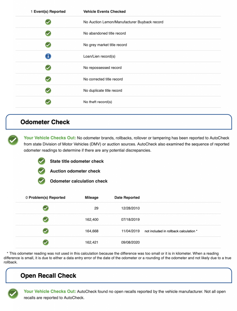

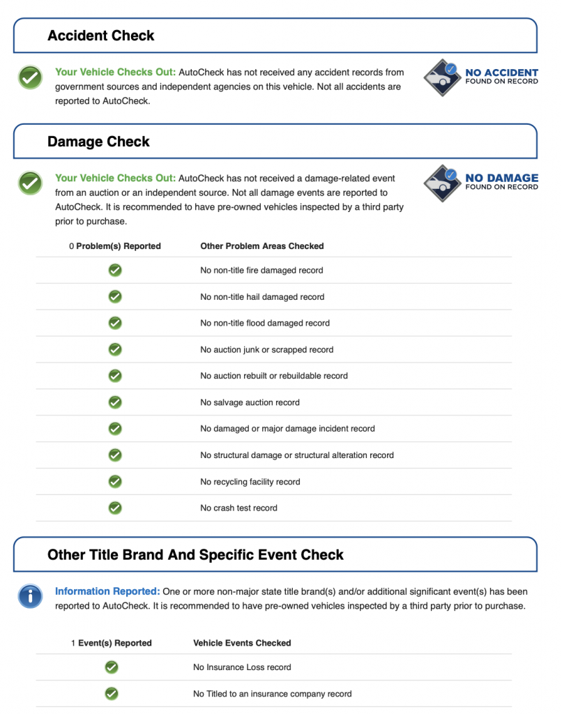

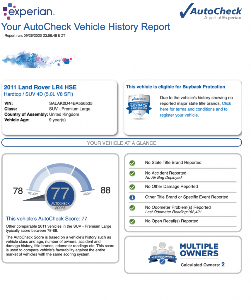

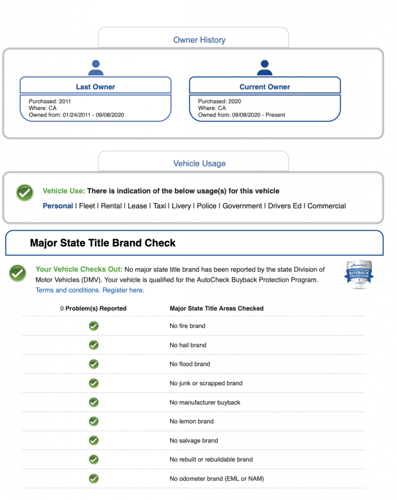

Thank you everyone for your comments according to your past experience. Ive reviewed the CARFAX and seems to be everything OK, however i was curious about the ownership lenght of each and asked why he has it for only a month. and about the mods and care of the vehicle... This was his response}
We’ve had it for a few years but wasn’t transferred until last month. I’m a dealer and have my dealers license here so they can stay in my inventory for as long as I want and I decide to make it my daily driver so I transferred it so I can I sure it under gieco and not my bond. The work, lift tires and rims were put on by me. No rust in California and none rust vehicle. This vehicle has one owner before I purchased it and it was a daily driver with no off road sessions.
Even do i like the vehicle ill always be skeptical from a dealership. Ive been browsing nationwide and this is the one ive been more leaned to (5.0L V8s rather than the V6)... however i dont like to be in any rush of being the one that i might think is the one and end up fixing a loose chain... i would really appreciate your comments this vehicle.

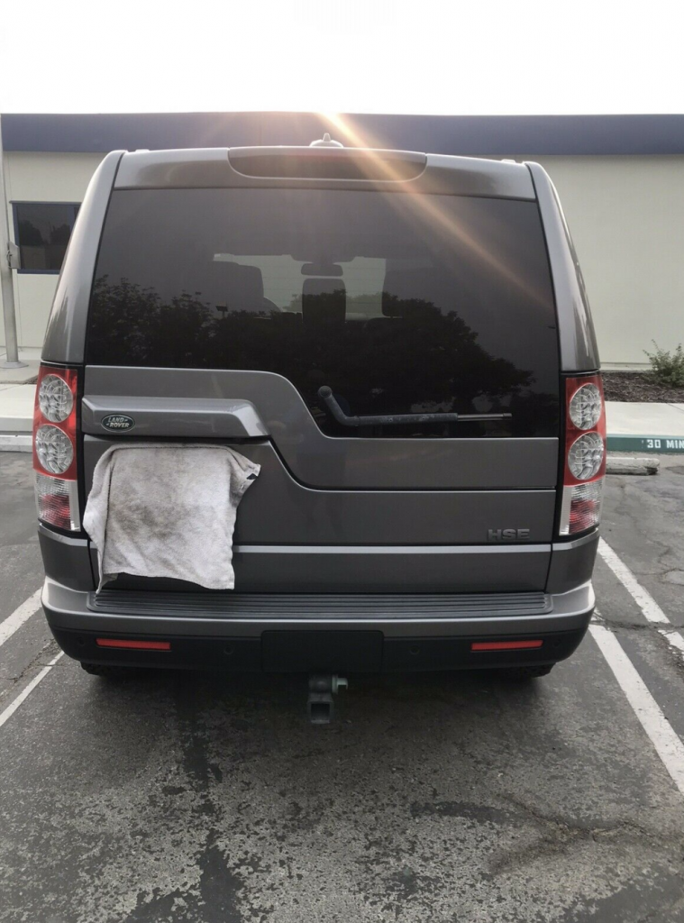

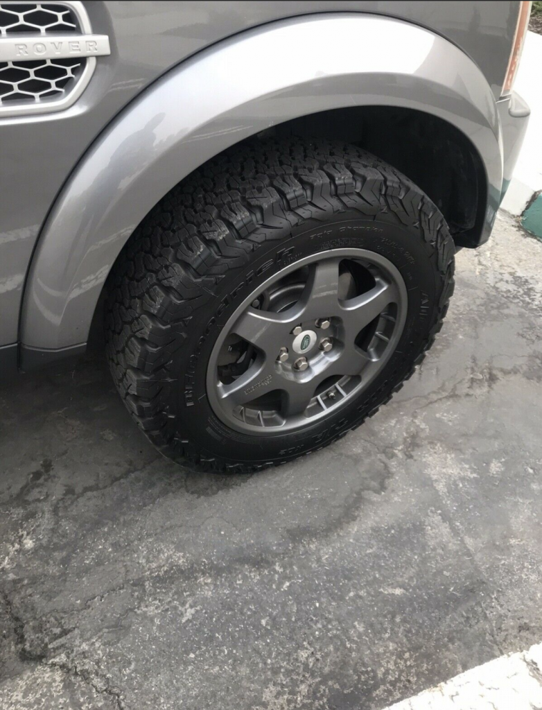

Here are some videos on idle and pictures

Thats a kind of crappy carfax.
Where are the service records?
Why is the odometer lower now than it was nearly a year ago? Lost 2000 miles?
