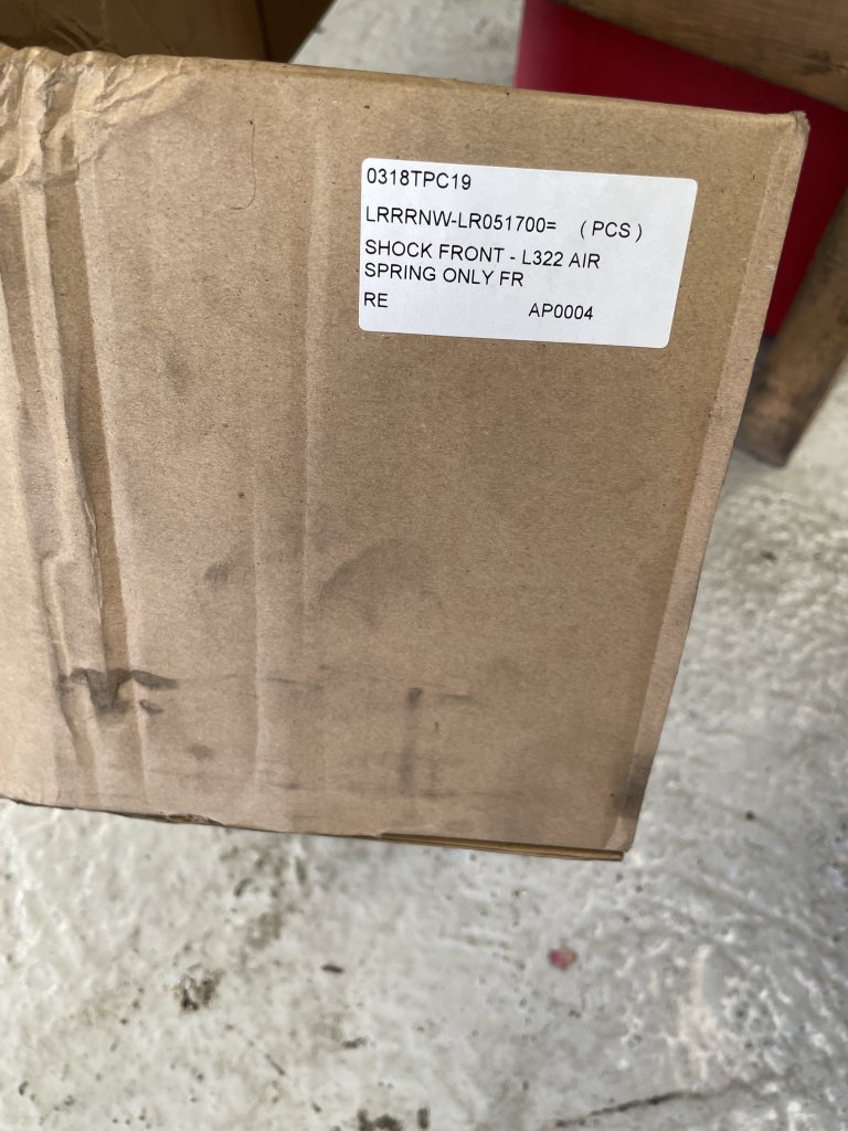

The fronts do look very high, it looks like it is at full height and the rear looks normal. Did the sensors get bent? What air bags did you put in?
Yes and that is in normal mode. The old sensors did not get bent. These are the brand my friend sold to me.
You must be registered for see images attach

Fits
  • Range Rover Full Size 4.4 (BMW Engine) | 03 - 05 | W/O ADAPTIVE DAMPING
  • Range Rover Full Size 4.4 (Jag Engine) | 06 - 09 | W/O ADAPTIVE DAMPING
  • Range Rover Full Size 4.2 Supercharged (Jag Engine) | 06 - 09 | W/O ADAPTIVE DAMPING
  • Range Rover Full Size | 10 - 12 | W/O ADAPTIVE DAMPING
  • Range Rover Full Size Supercharged | 10 - 12 | W/O ADAPTIVE DAMPING

H
Fits
how can I check if the vehicle has the adaptive damping?

From what I see in this video, if you have it you will have the sensor on the top of the shock mount.
