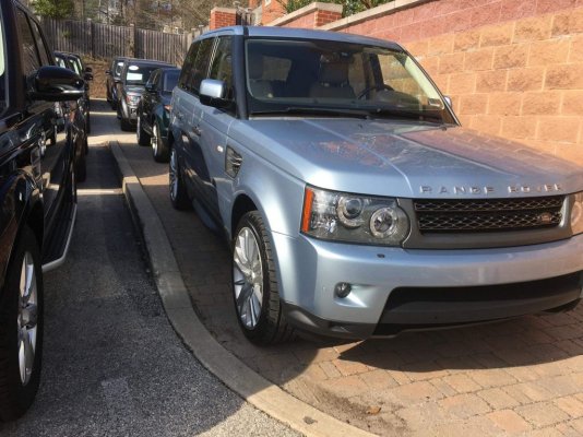

Please they useless car especially that 2011 Sports i have a one dead we still cant figure what is the problem.....i will give it up for 5k.
