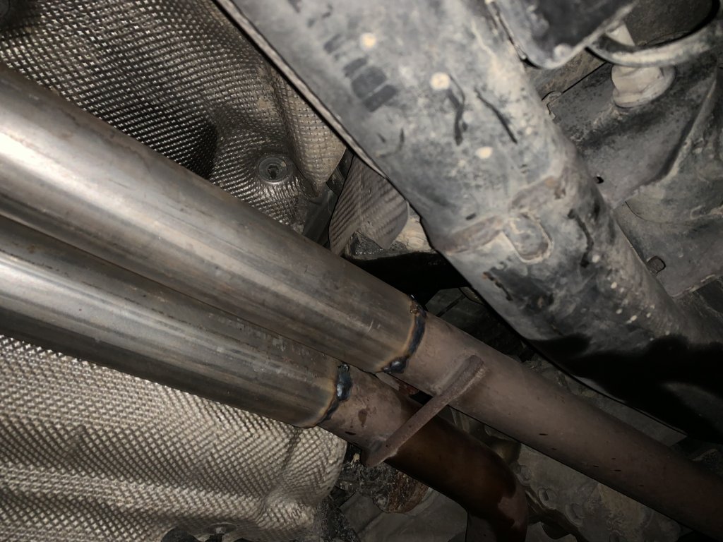

    Here’s a cold start of my rover. I removed the muffler, mid resonator, and two back resonators by the tips. I added two Magnaflow Magnapacks and straight piped the rest of it to two aftermarket tips. It sounds ferociously loud upon a cold start up and when you’re gunning it on the street/highway...however it sounds factory stock at idle. There is slight droning around 75-85mph, but I’m 27 years old so I don’t care. Also 55mph is legal anyways in NYC traffic lol. The truck sounds really mean and not "cheap n rusty" at all. The 5.0 jag v8 was way too quiet from the factory and it was more suited for the older folks up in the Hamptons. Some will hate and for that I agree it’s not for everyone. I guess in a couple years when i'm older with a family ill be tired of it and put all the original exhaust parts back on. The entire exhaust system cost me under $200 about a year ago to do.

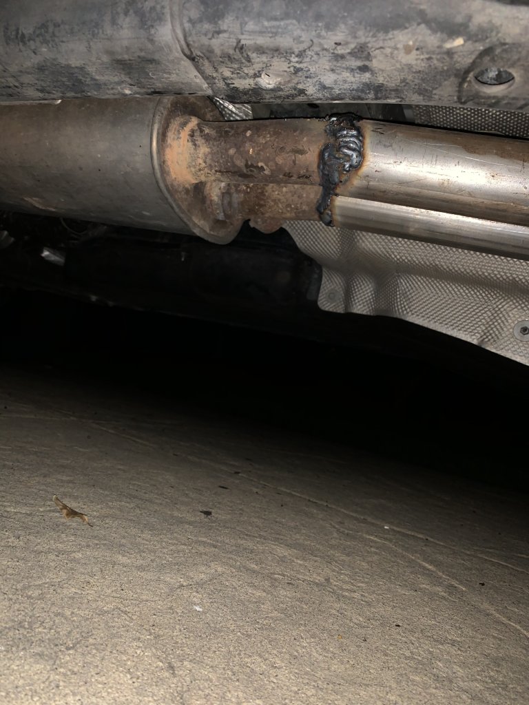

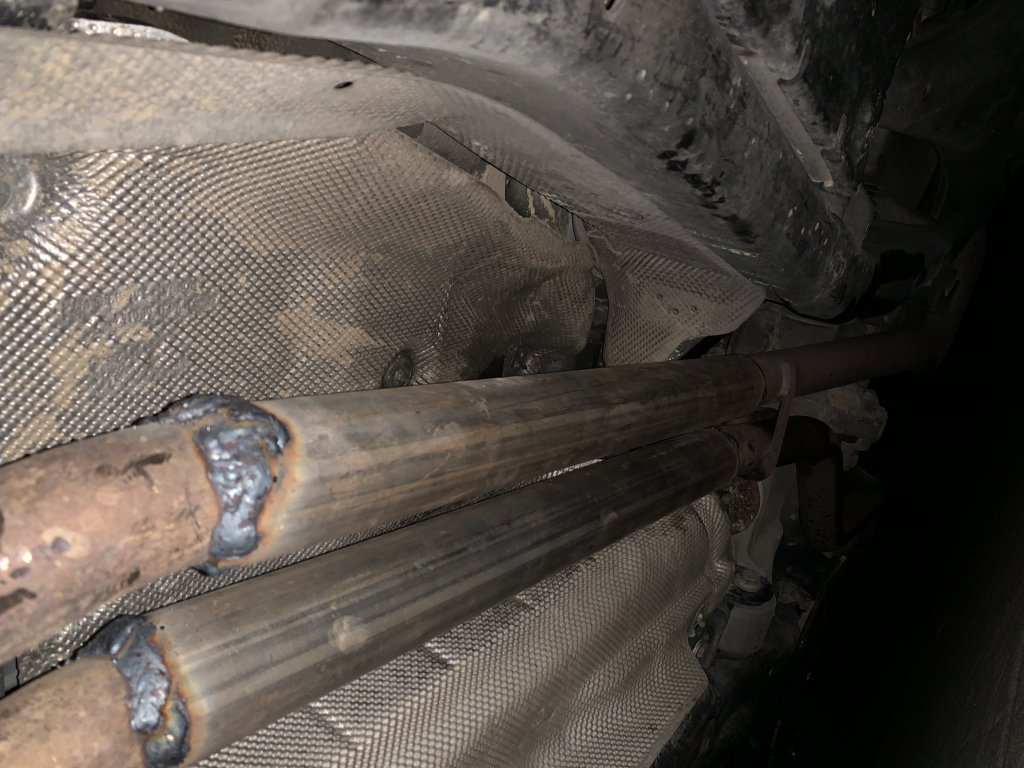

    I took the center resonator off my truck aswell. I will say that I’ve gotten very used to it and there is a little vibration through the cabin but the sound this car makes is amazing. When your on the gas it puts a smile on your face but it’s not loud enough to turn peoples heads. Pops and bangs when your manual down shifting and the torque converter locks up. It’s perfect in my opinion and I’ll provide some photos of the job.

    You didn't weld that did you?

    no I had a shop do it. I had them weld bigger pipes and then slip them over the cut exhaust pipe and then weld them so if I ever wanted to stick the muffler back on I could easily.
