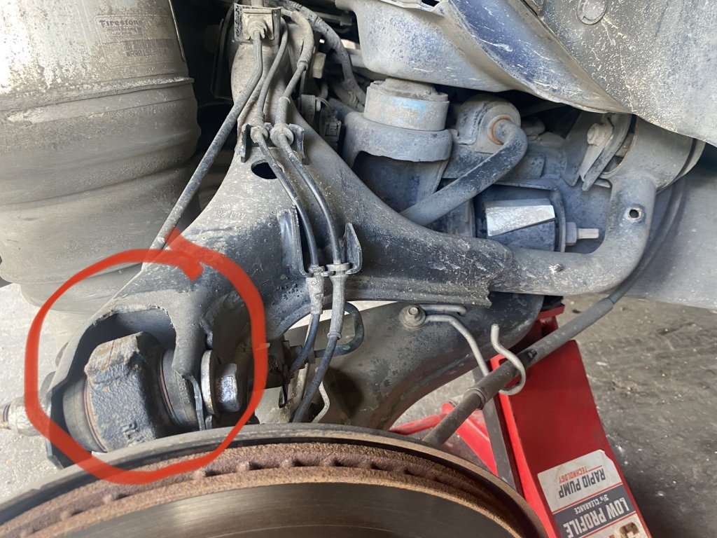

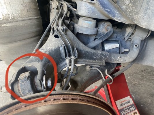

This guy is wearing out on mine & the clunking is annoying at low speeds & over bumps.
Replacement ordered.
