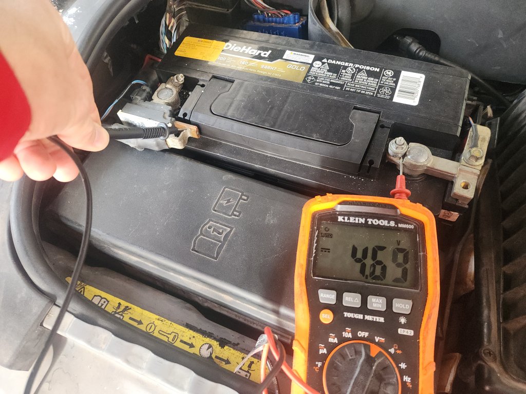

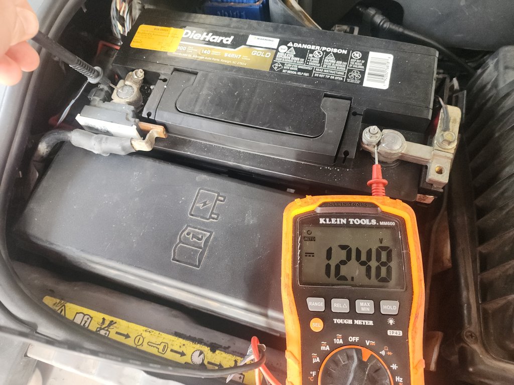

Followup! After months with zero symptoms, the truck appeared to have a dead battery this morning after being rained on.
When checking the battery, i get 12.5 volts, but only 4.5 bolts leaving the relay (?) On the negative battery cable. Photos attached.
I'm not sure if the issue is the neagtive battery cable itself or an input to the body control module causing the relay to open. Unplugging the 2 wire connector (on the relay module on the negative battery lug )does not change the 4.5v reading.
I think i should just change the battery cable, has anyone had a similar experience with these negative battery cable assemblies seemingly going bad?

Great diagnostic test.
The negative battery cable needs to be replaced. Excessive resistance in the internal contacts.

I wasn't sure if that device was a current measurement shunt or a relay/mosfet, but either way, I've ordered a new BMS/negative cable assembly new and will disassemble the original after I swapped get the new one installed.
