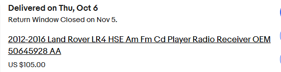

I had issues with my radio head unit where it wasn't saving the last station listened to (or favorites)... I ended buying a replacement head unit on eBay and have never looked back, here's the thread which also has some links on how to get in there (it's not terrible if you're somewhat handy):
Thread with the links:
One key thing is to loosen up the center console as that helps remove the two side pieces around the radio. I still have my old head unit if you need another unit to test but obviously it comes with the caveat that it doesn't store stations but it does/did work.

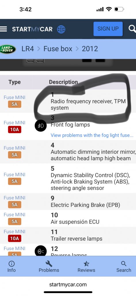

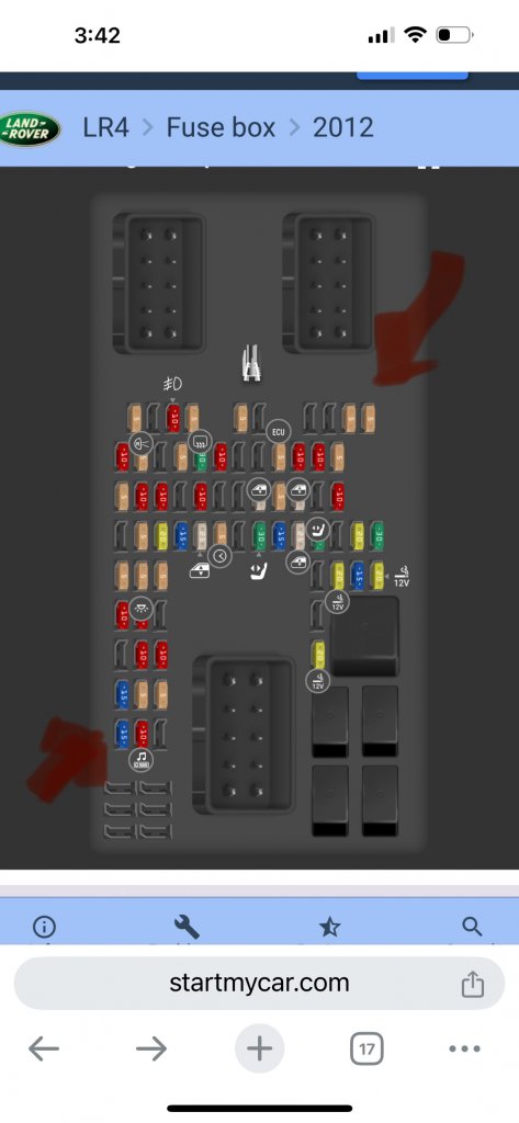

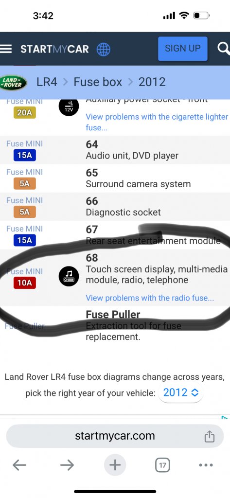

Georgemera1
Mar 7, 2012
100
20
Thanks very much for all the replies here, this radio issue is really stressing me out.
I did try a couple of things, like resetting my car unplugging the battery for like an hour, I did remove the fuses for the radio, telephone, multimedia, etc and radio receiver but non of it worked.
Can somebody else help with other ideas on how to resolve this issue?
I did google this issue and found many people had this same problem but nobody really wrote how they resolved it.
(Check the pictures below)
Thanks very much in advance,
George,
