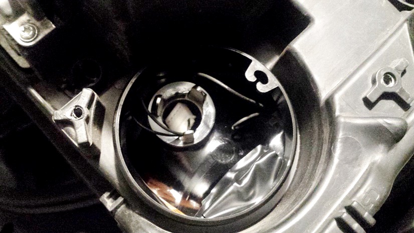

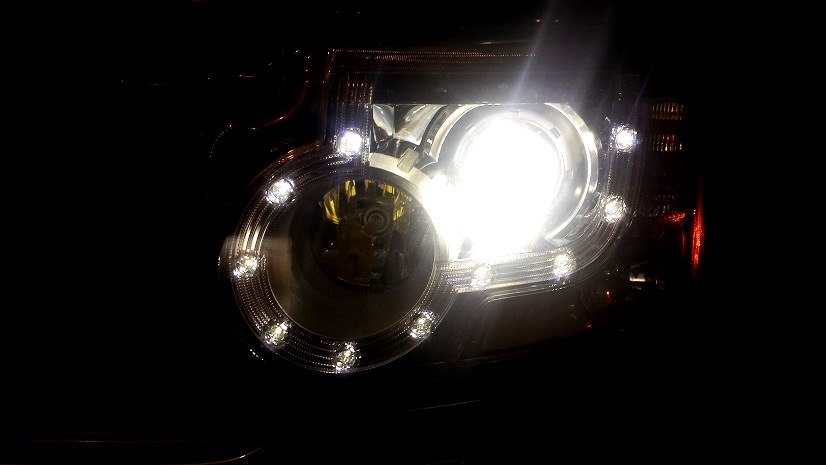

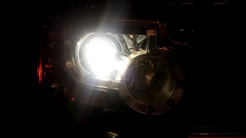

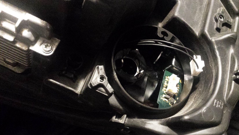

After searching the forums and youtube for possible options on disabling these peculiar lights I decided to take apart the headlight and go at it myself. It is a fairly simple process and if you have about twenty minutes of free time, a 7mm socket and black electrical tape you can disable them as well without IIDT or any CEL or error messages. Attached below are images of what to do and where to do it. I hope this helps anyone looking to do disable these lights down the road. Enjoy.
Before:
After:
