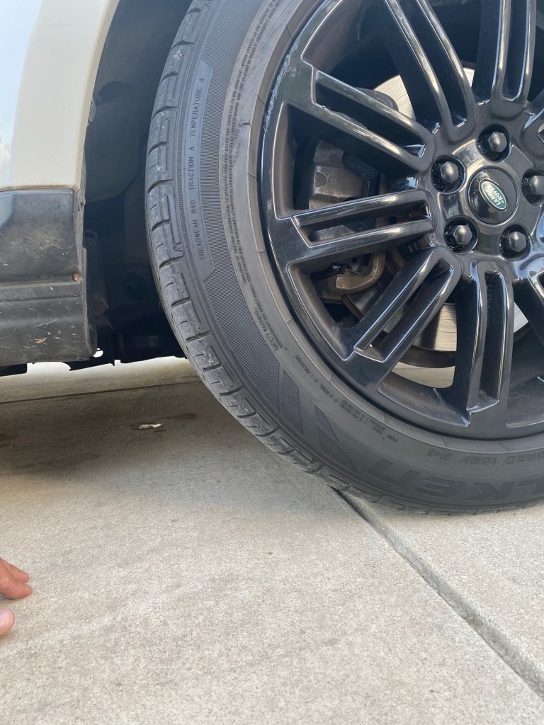

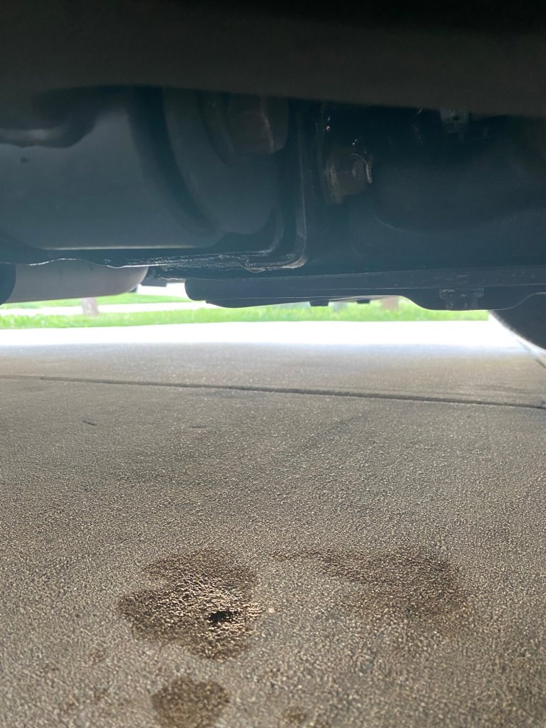

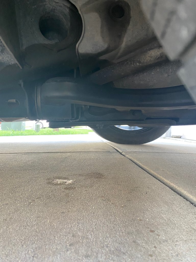

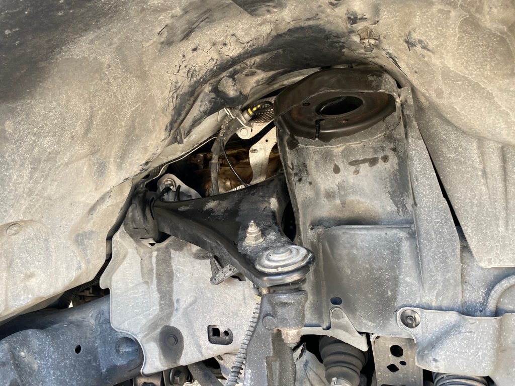

Part of me that thinks its a oil leak is that I have had a few drops on my driveway. It seems to be dropping from the passenger side front right near the control arm bushing. I do not believe it is the actual oil filled bushing leaking because the undertray nearby is a bit oil soaked. Picture below:

Valve cover is the first thing that comes to mind in that video you posted. Oil dripping down onto the manifold maybe. But an oil leak from the drivers side valve cover would not be flowing to the passenger side control arm. You might have valve cover leaks on both sides. Valve cover leaks seem to be pretty common on these cars.

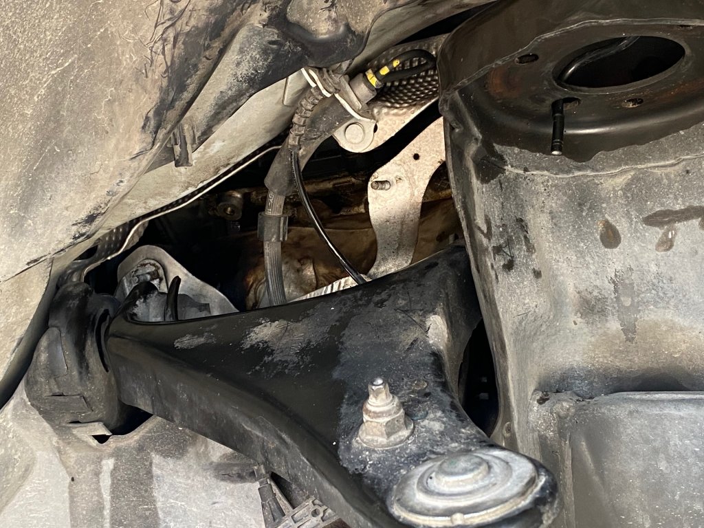

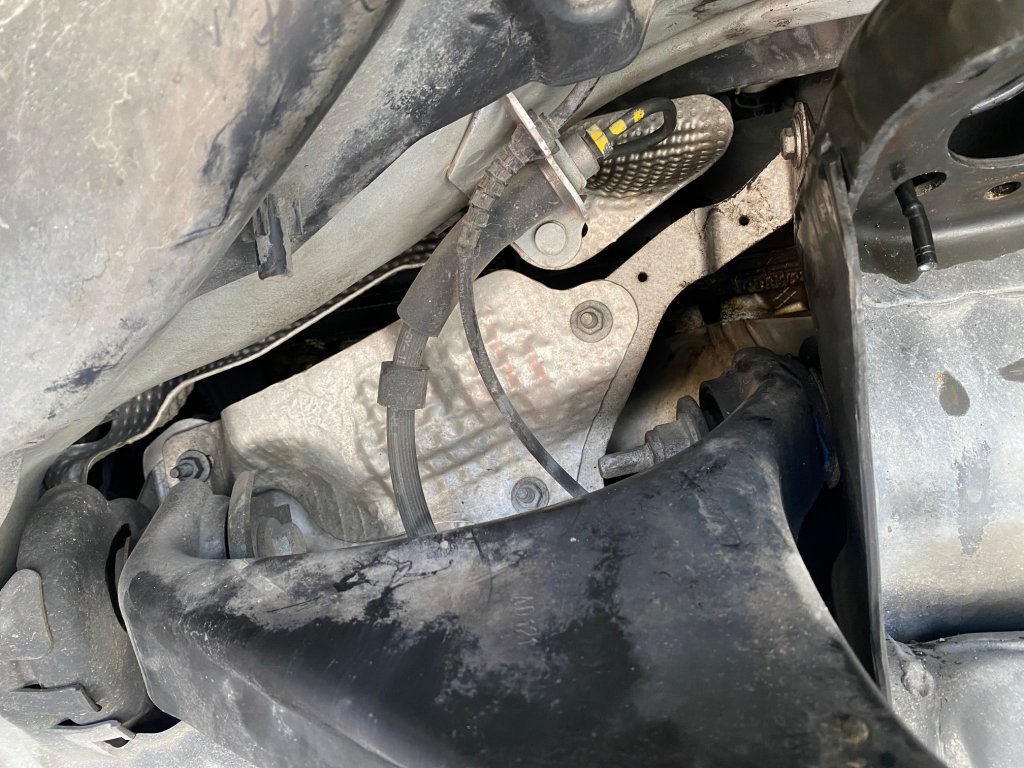

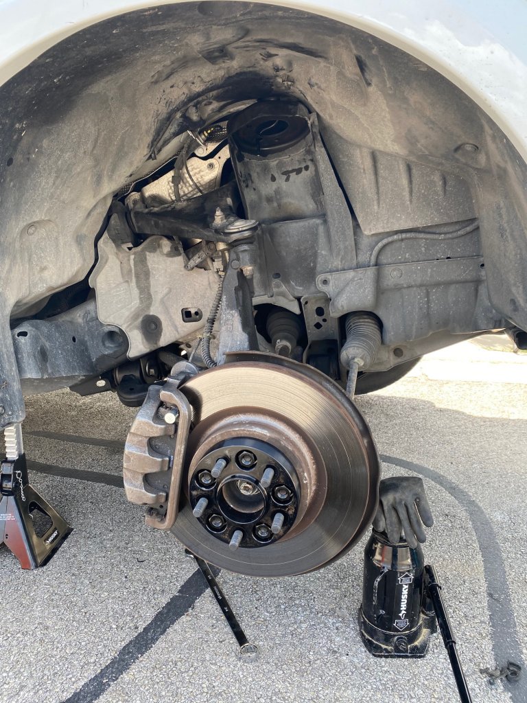

So when I was changing out my air springs today I believe I found the source of my white smoke / oil leak. While working on the passenger side, which is where I happen to have the leak at the bottom from the pics above, I removed a miniature heat shield and I believe this provided a better view and some access to a portion of the valve cover gasket (If I am not mistaken). From the looks of it there is some oil leaking from the rear of the valve cover gasket and that is dropping onto the exhaust manifold (which is quite black as you can see from the pictures) and this is causing the white smoke as the oil is burned off when the exhaust manifold gets hot after driving.
I wiped the area a little to take some pictures and from what I can tell at there is a bolt missing at the rear near the source of the oil leak. I am not certain if this missing bolt is the cause of the leak but I am needing some assistance in determining the part number so I can replace this missing bolt as a first step. I tried looking up some diagrams to figure this out without luck and not too sure how to go about finding the right bolt. If anyone can help I would greatly appreciate it.
