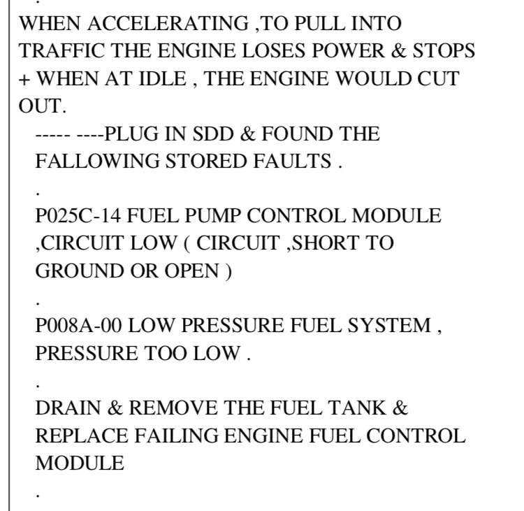

I start the truck, let it settle down to idle rpm. No issue until it settles, it dies. Check engine and battery light illuminated. If it tried starting it again immediately without completely powering down the car, it’d just try to turn over without success. Id turn it completely off and restart and it start right up. This would happen like one out of 30 starts maybe.
Then, it expanded. In addition to doing that every once in a while, it began dying moments after taking off. I start it, it settles to idle rpm fine, I put it in gear, accelerate, within maybe 2 seconds it dies. Same dash lights lit up, lose power steering and breaks. I still have radio and AC I believe when this happens.
First time the shop had it, they changed a fuel relay. I don’t know exactly what, I didn’t get a copy of the receipt. Second time, the did attached. Now they seem to be at a loss and are investigating further.
