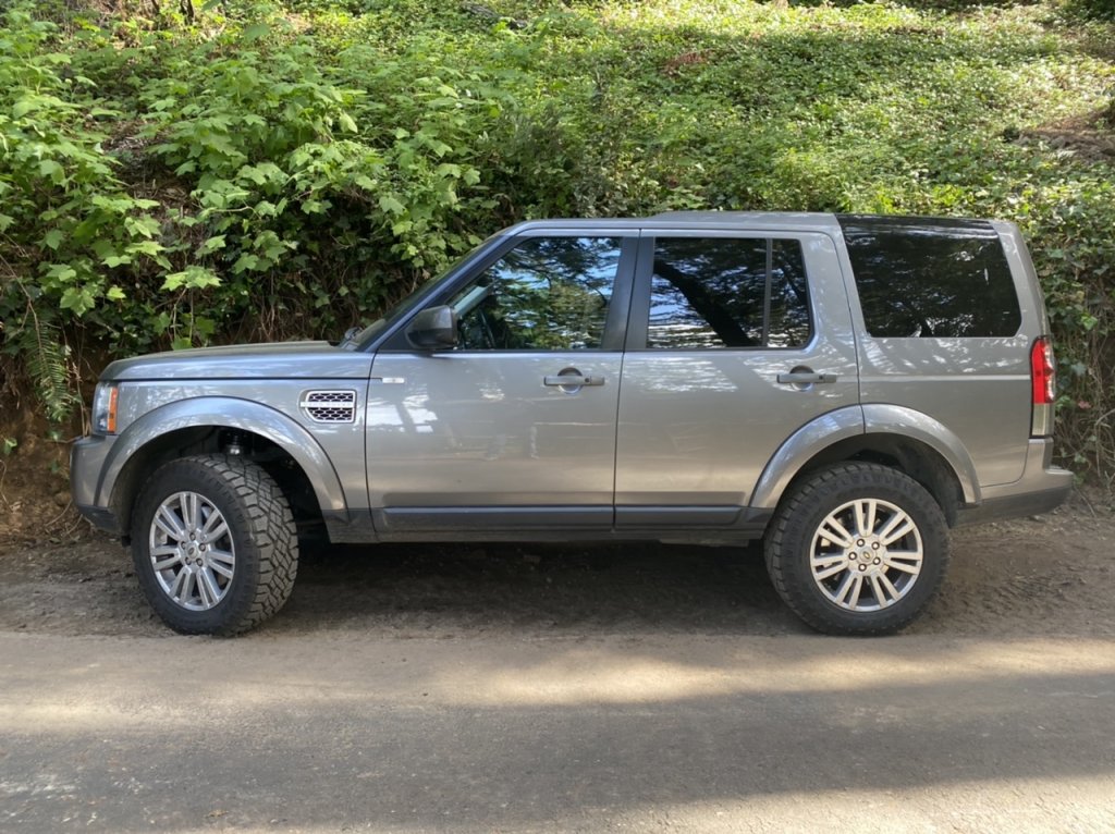

CaliLee
Feb 10, 2021
82
31
Santa Cruz Mountains
This is the SYA kit and 32.1” tires on 19” rims (255/65R19)
TrinidadLR4
Nov 27, 2018
455
265
NE Washington DC
This is the SYA kit and 32.1” tires on 19” rims (255/65R19)View attachment 12965
I think that tire size looks proper and very good on a 19inch wheel. Out of curiosity, did you try to fit it without the SYA kit? I am wondering how much they actually rub, if it's manageable or undriveable. 31.xx seems to be the limit for unlifted LR4s but i always wonder.
