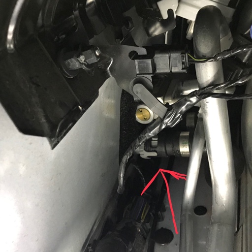

My wife’s LR2 is leaking coolant at one the hose connectors to the heater core. The one closest to the passenger side is leaking. I’ve turned the gray locking ring and repositioned the hose and turned the gray ring back but it’s still leaking from that connection. Is this common for those quick connects to fail? I’m planning on replacing the hose assembly. Looks like I can access well through the wiper panel and under the module. Anyone have experience or suggestions with this type of failure? Thanks! Sent from my iPhone using Tapatalk

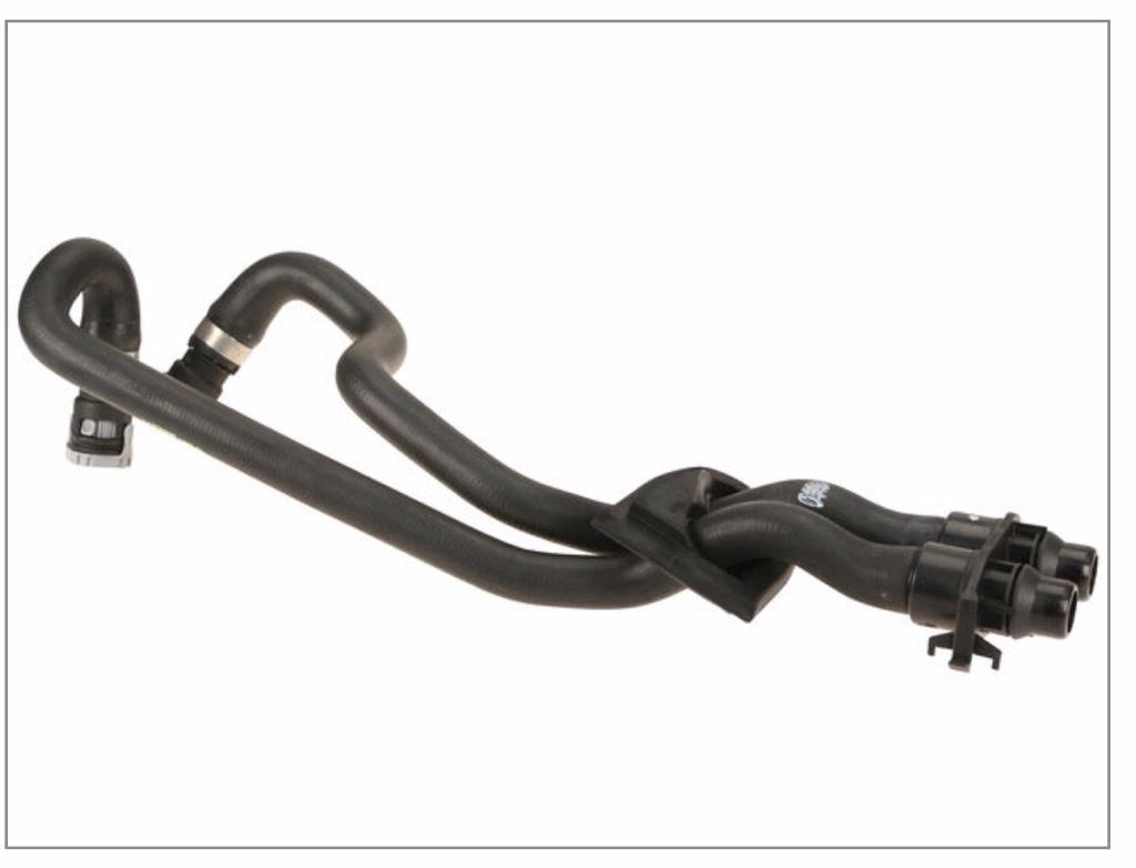

Sorry, didn’t realize there had been inquiries on this post. I purchased a replacement hose. It’s a small section that connects the heater core to the system with quick connects. LR parts counter rep said it’s a known issue with those connectors. Took a little manipulation of the hose to get it into place. Had to remove the wiper arms and cowling to access the hose. Took just a few hours start to finish. Sent from my iPhone using Tapatalk
