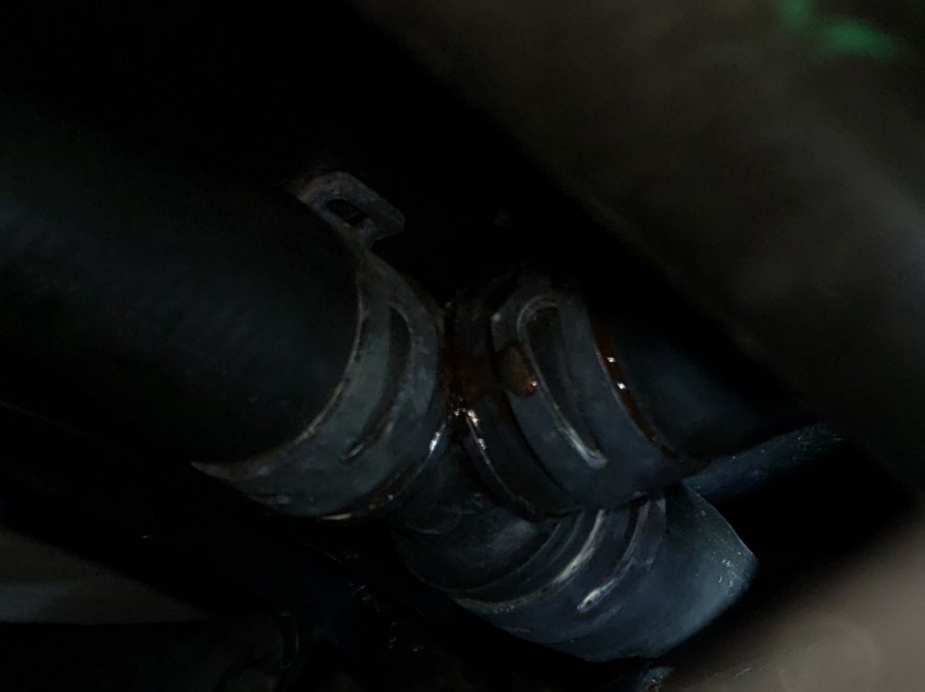

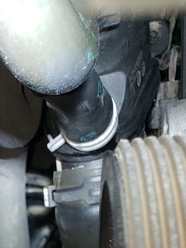

Here are two pictures, one of the thermostat looking up from underneath. You can see the dark spot on the black plastic is fluid. The second is of the T connection at the base of the coolant fan and radiator where it seems to all be gathering. The guy at the parts desk was almost certain that the thermostats aren't usually the problems on these trucks but who knows.. I'm still between thermostat and hose and can't decide which.
