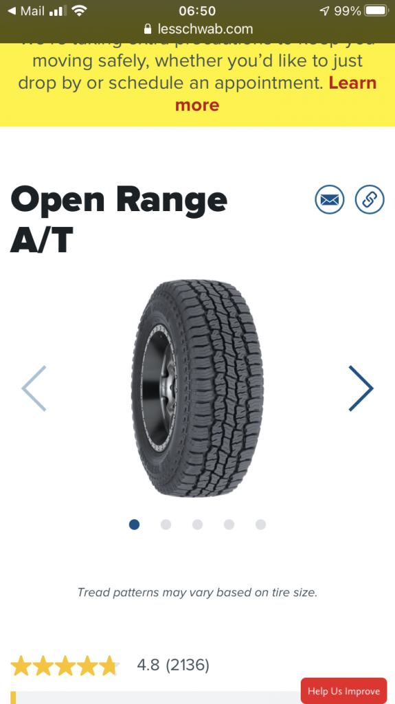

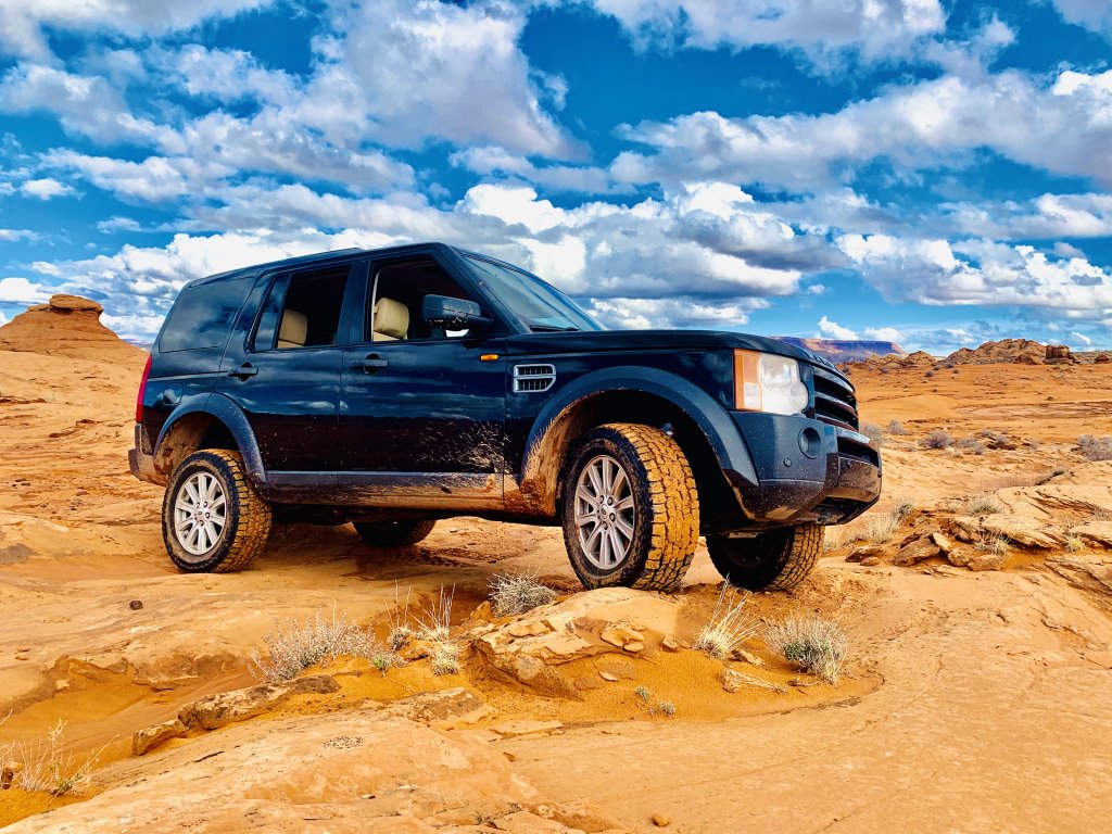

    This is one of mine in action down in the sand, rock, and mud of southern Utah last spring. By the way, if you are unfamiliar, the sand down here is like driving on baby power and when wet will cake any tire, no matter how aggressive. (Check out this YouTube channel to see the area suck in the inferior vehicles!! Matt’s Off-road Recovery)
    This is one of two a daily driver on 265/60R18. This is a pure stock 2007LR I own, I have also put these on my Nissan Titan but that is a story for another forum. I originally put 265/65R18 on by they had a slight rub when I turned hard right out of the parking lot. So I went back down one size. The tires are Open Range (LesShwab’s version of the Toyo Open Contry)
    https://www.lesschwab.com/open-range-a-t-tires-126232075.html

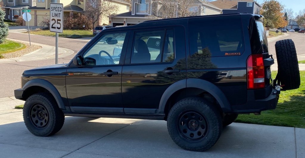

    I also have the Les Schwab Open Range A/T on my 06 but in the 265/65R18. I have a Rhino Rods lift and 18" steelies. I like the performance on and offroad but wish they looked a little more "aggressive". :rock:
