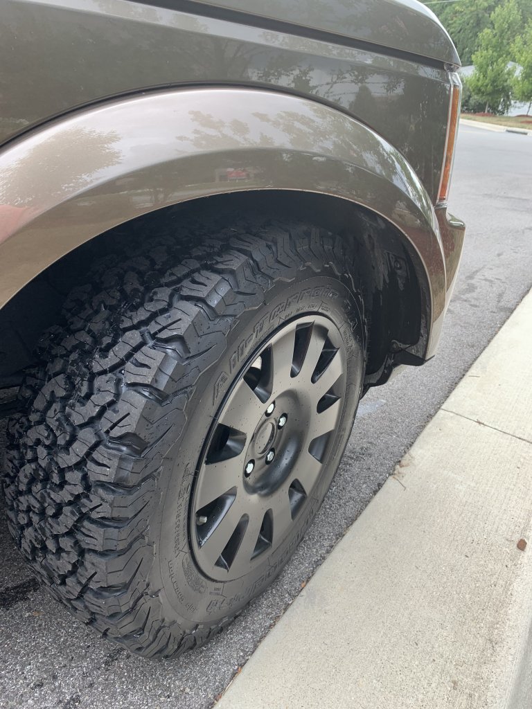

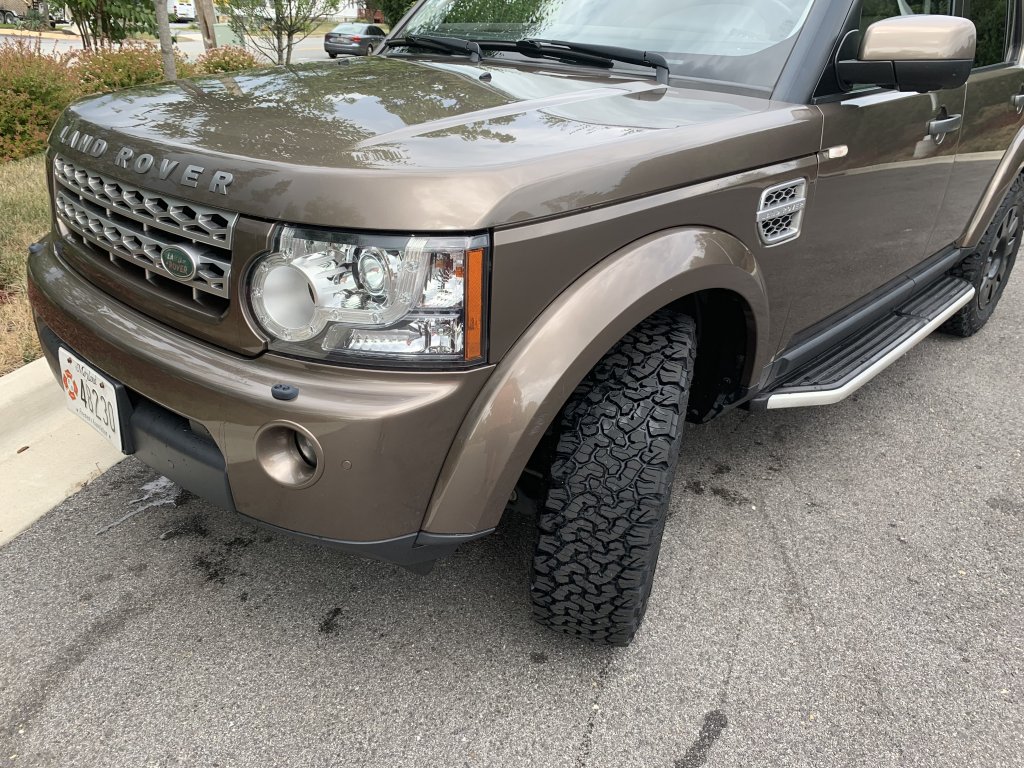

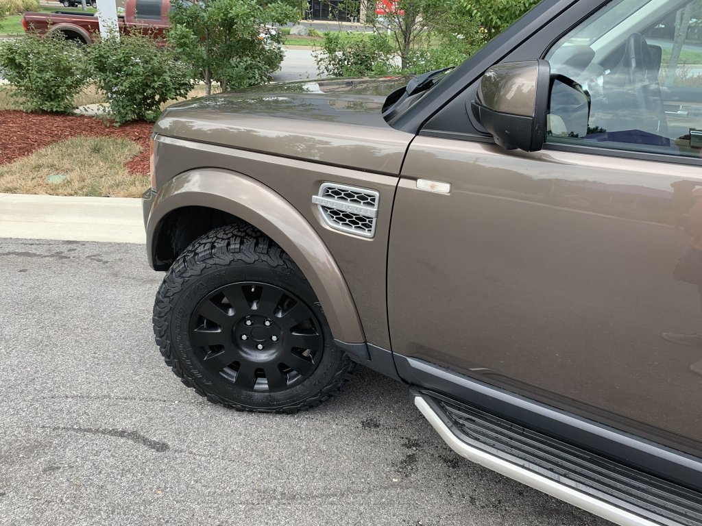

ended up with 265/65R18. BFG KO2 ALL TERRAINS.
i like them. quiet on the road. and very good road handling and off-road use has been light so far but intend to test them out at a off-road gathering next month!

BTW... no rubbing with the 265/65R18 at full lock. I'd like a larger/wider tire someday but for now...I'll test these out for about 40k miles
