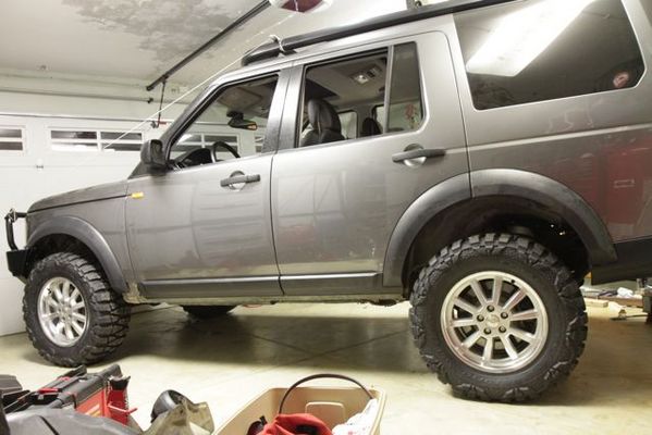

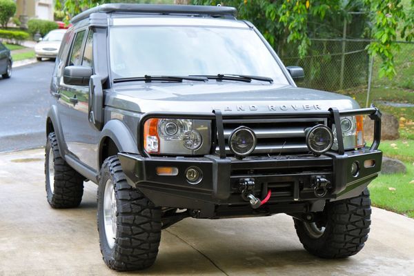

I came across a thread on the Disco 3 UK forum with a guy running 33x12.50R18 Nitto Mud Grapplers on an LR3, and now I'm intrigued. It won't let me attach a link to the thread, but it's easy to find with a quick Google search. I have attached a couple of photos from the thread.
It seems like quite a bit of modding was done to accommodate them, but I'm wondering if anyone with an LR4 has attempted this. If I was able to do a 33" tire, I would probably lean toward the Toyo Open Country Mud Terrains, but the tread pattern of the Nitto Mud Grapps is very interesting. Right now I'm running 265/65R18 BFG All Terrains, which come out to a diameter just under 32".

I'm honestly not sure what the offset is on my 18" Fuel Boost wheels and how it would affect a larger tire option. The dealership did the fitting and ordering of my wheels and tires, so I wasn't too involved with all the specs. Is a larger offset better or worse? I love my BFG All Terrains so far, but I would definitely consider a mud terrain instead (or in the future). If I went this route, 33's would definitely be ideal. So many options too.
Here's a photo of some 285/65R18 Nitto Trail Grapplers on a Lexus LX470. I'm pretty sure that comes out to 32.6".... that might be a nice option as well.
EDIT: According to the Johnson Rods website, I should be able to clear a 285/65R18. Hmmmm.....
