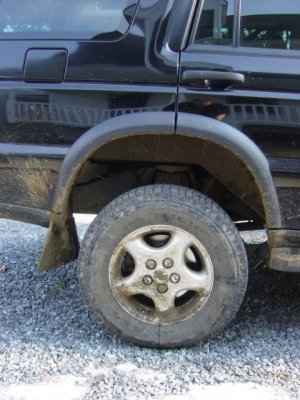

Went offroading last night in our 1999 Disco series 2. Have the truck in low and raised the rear end using the SLS button for more clearance. The right rear will not lower. Any thoughts about what could be malfunctioning? Thanks.

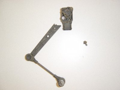

Here is the broken part in question. You can see that the plastic arm snapped at the sensor.
Found the part online for $59. Sold as complete assembly (sensor+plastic arm)
Part number on the sensor is RQH 100030 for future reference.

So, you broke the switch, no options, got to buy it as a complete assembly, I am pretty sure.

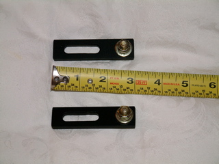

If you ever want to be able to adjust the height of the rear suspension by as much as 2"s these are a fun addition from RTE.

That part I showed use is an adjustable extension so if you want to put a lift in the fron you can adjust the rear to match. For somereson I thought you had a lift, OH WELL
