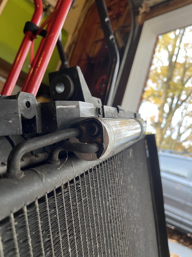

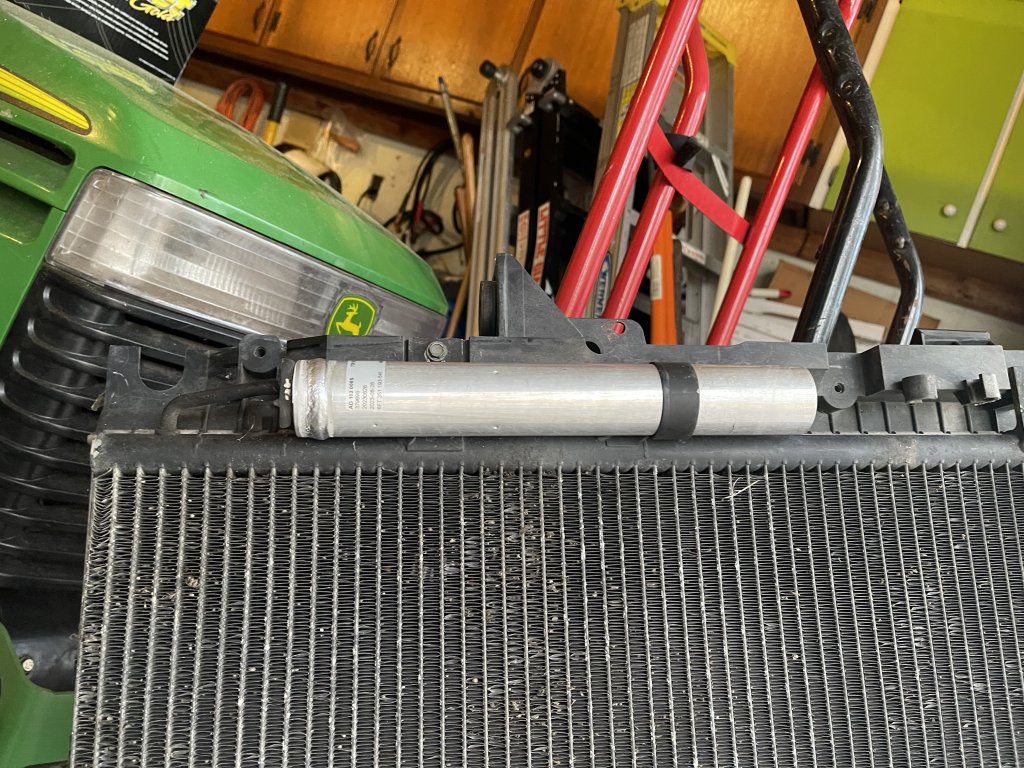

As I'm in the middle of an engine swap, I thought it best to replace the AC condenser since the system has been evacuated and disconnected....and it's gonna sit for like a month. Basically, I expect the receiver drier to be toast, and really anytime you crack these systems open, it's a decent idea to replace the drier. Unfortunately, our receiver driers are soldered to the AC condenser. Since I'm just finishing a move and can't get to my torch and soldering supplies, simply swapping the whole assembly makes sense...and because that's how it mostly comes, as a combined unit.
So, the question I have is has anyone done this swap, and more importantly, which "version" of the part did you use? Thus far I've found 2 different "styles," but I have no feedback aside from, the OE has worked this long...
Style 1 is the OE style:
Style 2 is the aftermarket "upgrade":
Clearly, the aftermarket style appears to be made a little sturdier, but sturdy comes at the cost of potential heat sink surface area. And to be honest, I've flipped the OE one out of the way all the time and never had any issues with it holding up.
Anyone out there run one of the aftermarket versions? I'm tempted because of the price difference, but let's be honest, that could backfire in a heartbeat!!!
Thoughts, comments, recommendations?

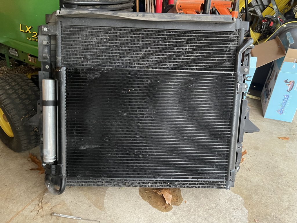

I know it's been a hot minute, but I finally got all the "honey-do" projects done at my mom's place and had a few minutes to work on my project again!
So, after our discussions here I decided to "just" buy the charcoal canister and see how things went. Truthfully, with the cooling core out it was very easy! There's one screw holding the canister on the lines, and then the band clamp holding the canister to the radiator core. I went ahead and bought an aftermarket seal kit that seemed to fit just about right for the line o-rings. All in all this should work well, as it's a Mahle canister and I believe the OEM was Mahle...mine only cost like 20 or something like that, vs $70+ for the LR one.
