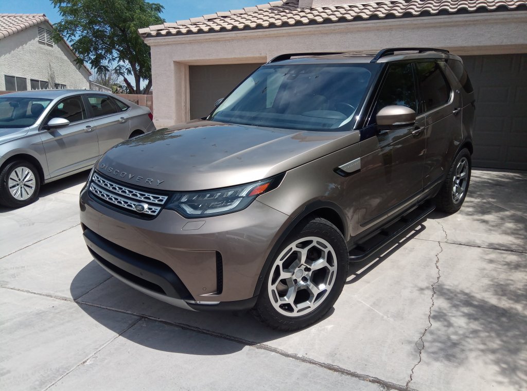

I've had no wheel alignment or tire wear anomalies since replacing the stock tires and 20" x 8.5" stock wheels (including the spare) with 285/50-20 Nitto Terra Grappler G2s mounted on 20" x 9.5" Redbourne wheels (and then, of course, getting an alignment at the dealer). Land Rover Las Vegas is the best dealership I've ever done business with but since it's probably not feasible for you to come here you should consider getting a realignment at the Land Rover dealership in San Antonio or Houston.
