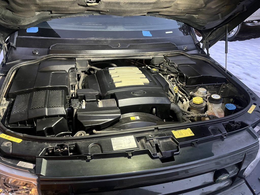

Installed a new front cowl as the old one was grey and warped. I applied Cerakote to it and while I was there I refreshed all the under hood plastic trim with Cerakote too, that stuff is amazing.

Cleared all the codes and runs like a champ.

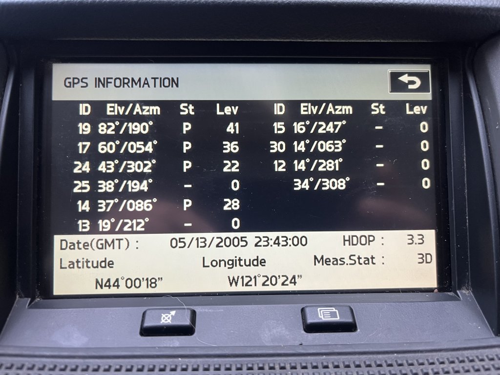

Replaced the Nav DVD drive/ computer thing under the drivers seat.
Now the Nav works!!

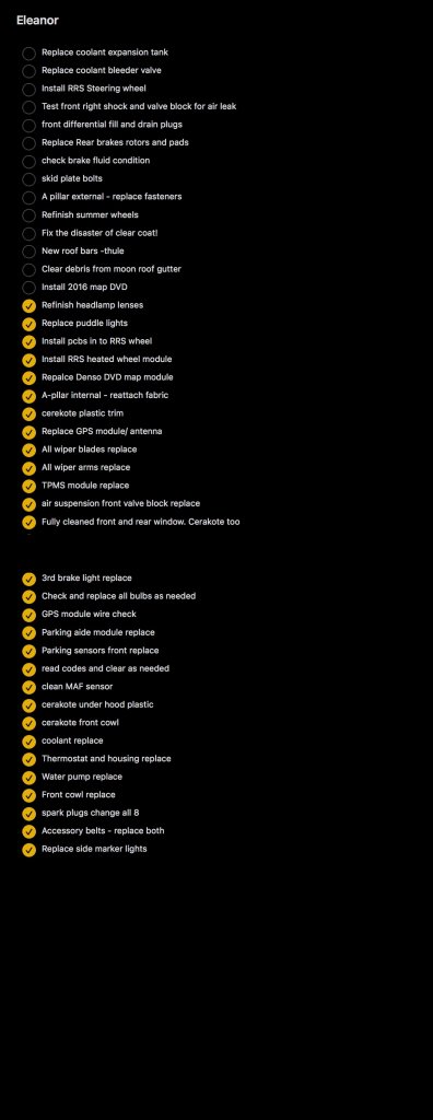

Here is the ever growing list and the status. It has actually been pretty easy to work on this truck..
