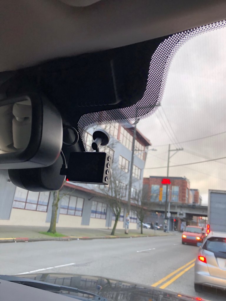

I installed a Garmin Dashcam (because they're tiny) and took power from the moisture sensor on the windshield.

Here's my install.
