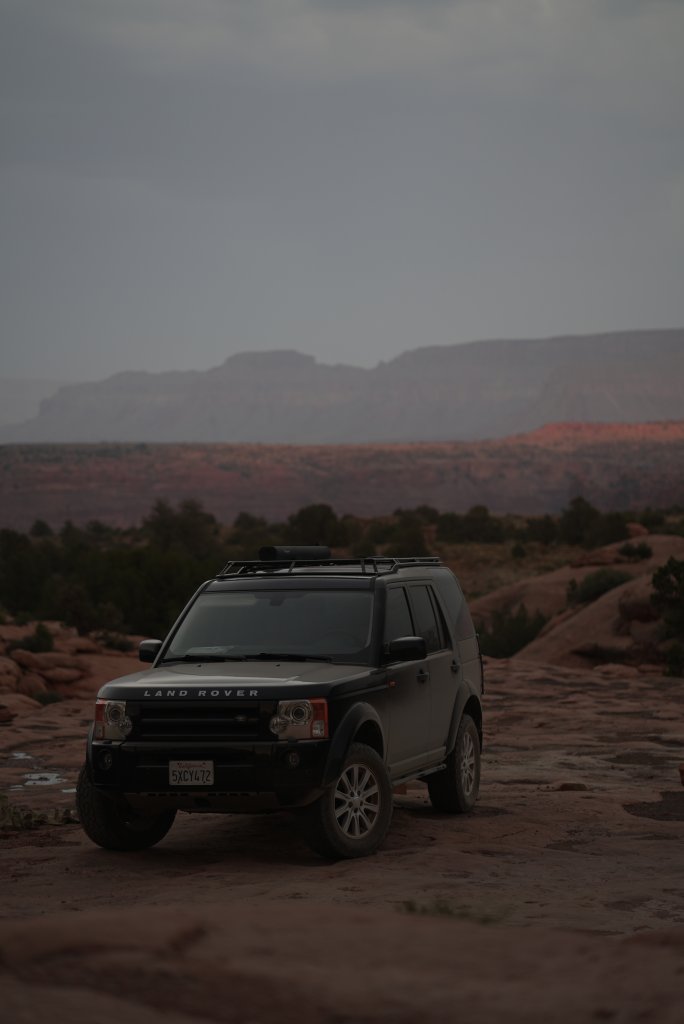

Hello, I am currently exploring the 255/55R20 Toyo Open Country III and came across the BFG Train Terrain T/A, which did catch my attention. My first step is to see if the 31 inch tire can fit in the spare wheel area fully inflated (I have TPMS) with the tow hitch adapted mounted. Will have an answer in a couple weeks. I am ordering "1" Toyo tire from Tire Rack and then having it mounted to see if it will fit. If it fits then I plan on running the 31 inch tires without Johnson rods.
Not in the same size as you're interested in, but i just got the Toyo Open Country III in a 265/60/18 about 3 months ago and have since done a big road trip from LA to Yellowstone and back with a lot of off-roading in between. My experience is fantastic by off the pavement and on the freeways. I recommend.

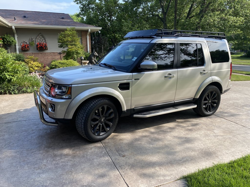

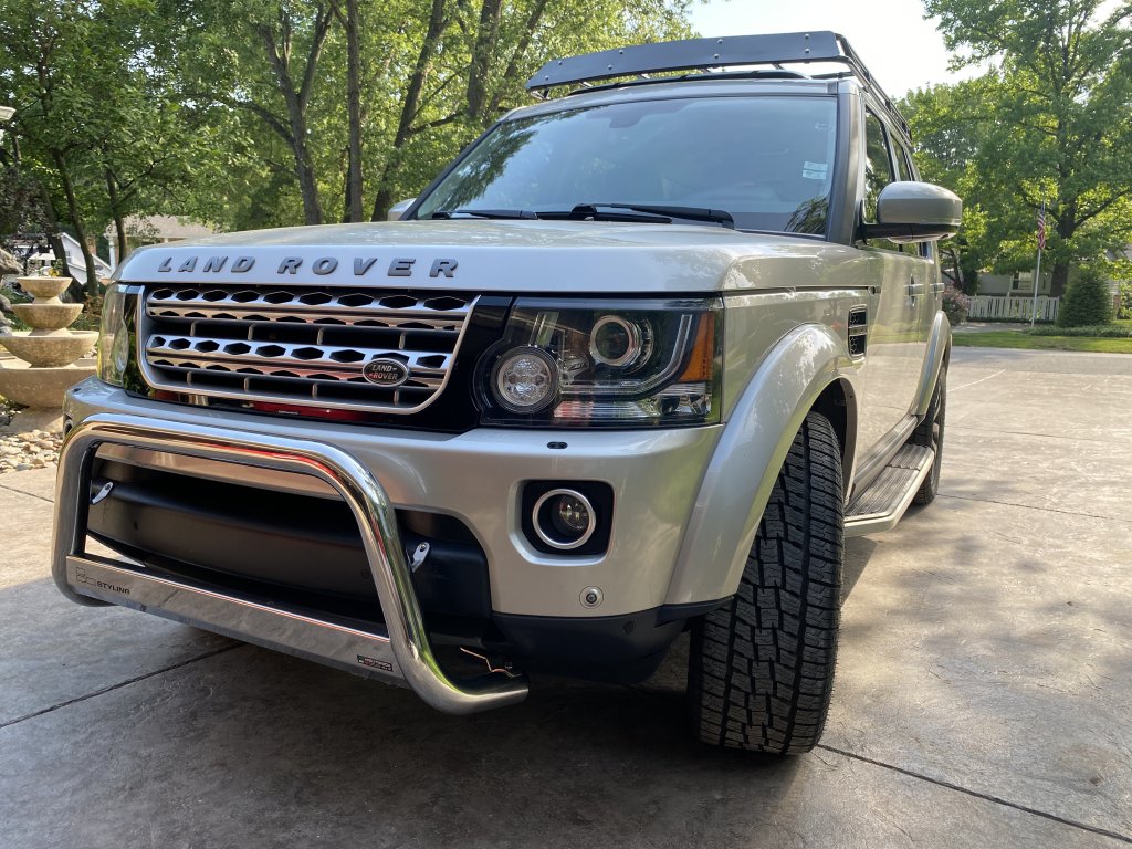

I’m running Lexani Terrain Beast 275/55/r20 no rub whatsoever. Stay as close to 31” diameter as possible and select a tire without to much sidewall tread and your golden. No mods
